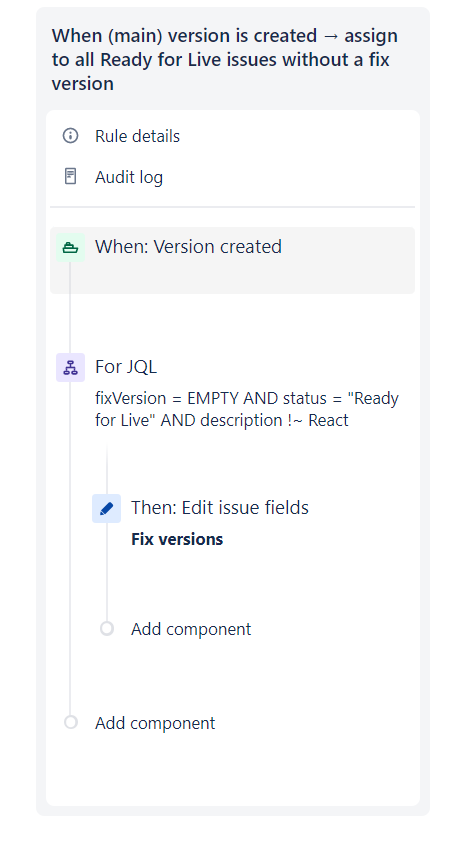

This is the current workflow

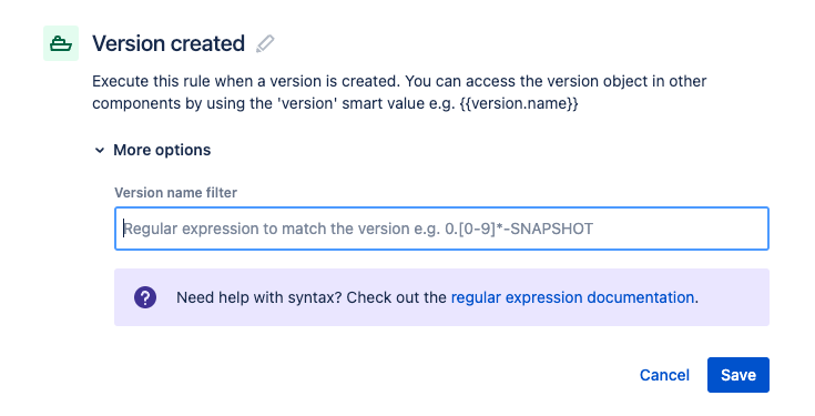

If you click on more options in the version created trigger than you can set a regex for the name.
I did see this but genuinely have no idea how to format it in order to work the way I want
Could you help with that?
I need some example versions from you
Is there no way to do it based on just containing some fixed text?
The version name is not important or in a defined format at point of creation, all that is required is (main) or (react) is in the name. When ready for release we then update the name to a version number but it still is suffixed with either (main) or (react)
I am not into regex but maybe "*REACT*" does it

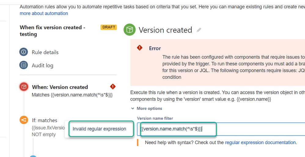

I am working on some automation using version created as a trigger, but I am getting invalid regular expression error.
I was trying to use the following to check not empty, it shows `invalid regular expression`. I tested `^\S+$` in https://regex101.com/. it is correct. But not sure using `.match()` function is right or not. Any ideas?
{{version.startDate.match("^\S+$")}}

Within the Version name filer box, if you want to filter description contains "React" then you can use
(?i).*React.*
the (?i) means don't care what case it is using, e.g. ReacT or reAct etc.
