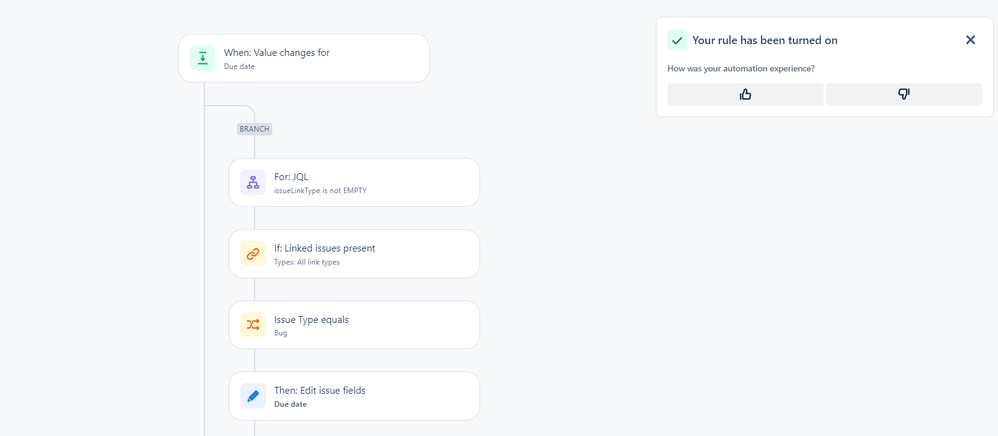

Hi @Jasmeen Bajracharya
The way you were trying to acheive keeps triggering the rule and keeps running as KP-18 is linked with KP-17 but however i have created an automation that is working for me and it updated the last linked issue and did not repeat itself here is the screenshot of the automation that worked for me2023-12-28_11h26_02.png

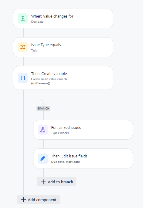

What you describe may be possible, but it is risky for an automation rule to process this.
You describe updating the Start Date and Due Date for linked issues, in a chain of issues.  This is similar to what a project management tool could do.  For example:
KP-15 links to -> KP-16 links to -> KP-17 links to -> KP-18
Your rule is only changing the issues linked to the first, trigger issue.  The reason is, by default, the actions of a rule cannot trigger other rules (or the same rule).  This is to prevent looping and errors, and serious performance problems in rule execution.
When one intentionally wants a rule to trigger others, the "downstream rule" to be triggered should enable the "Allow Rule Trigger" option in the rule details.  For your scenario, that would mean enabling the option for this rule, essentially making it recursive.
Now for the risky parts:
For your scenario, if there are ever more than 10 issues in a link chain, or any cross-linked issues (intentionally or accidentally), that single rule will halt.  It may also lead to other service limit breaches, and halt execution of all rules in your site.

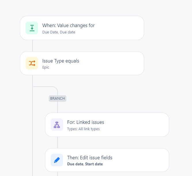

Hi @Jasmeen Bajracharya ,
To facilitate the automatic update of linked issues under an epic when the epic's due date changes, I have implemented the following automation:
Let me know if you have any questions or if further clarification is needed.

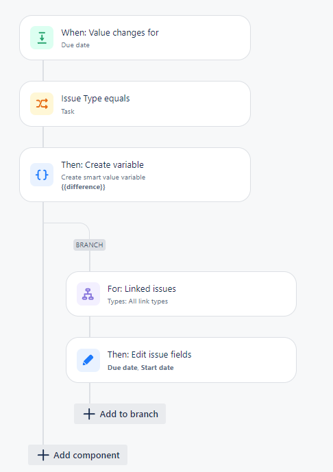

Hi, @Jasmeen Bajracharya
Try changing the Branch from linked issues type : blocks to All link types.
Thanks

hi @GNarsimhagowda - Empyra,
 Thanks for the prompt reply but though Blocks changed to all Link types, it is not changing the nested link issue,

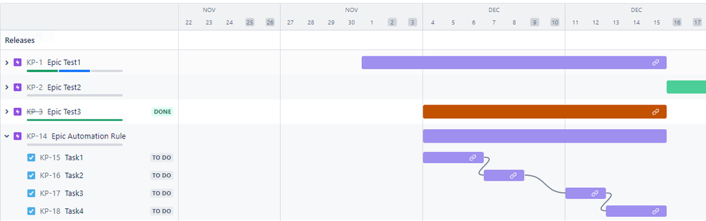

Before changing is as below

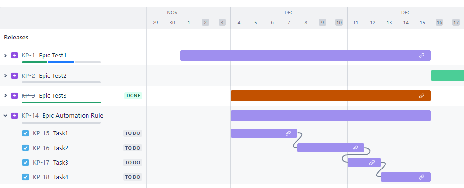

After changing the due date of KP-15
After case-KP15 due date cahnged then only KP16 start and due date changed automatically.PNG
as shown in above , Changing KP-15 due date from 6th dec to 7th dec, the start and due date of KP-16 only changed but KP-17 and KP-18 are not changed.
