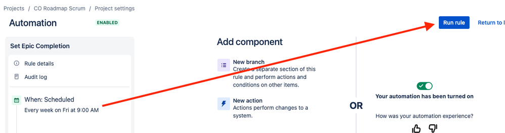

You can set up a rule with a Schedule trigger and still run it on demand using the Run Now button. You don't have to create a Manual trigger rule for testing.

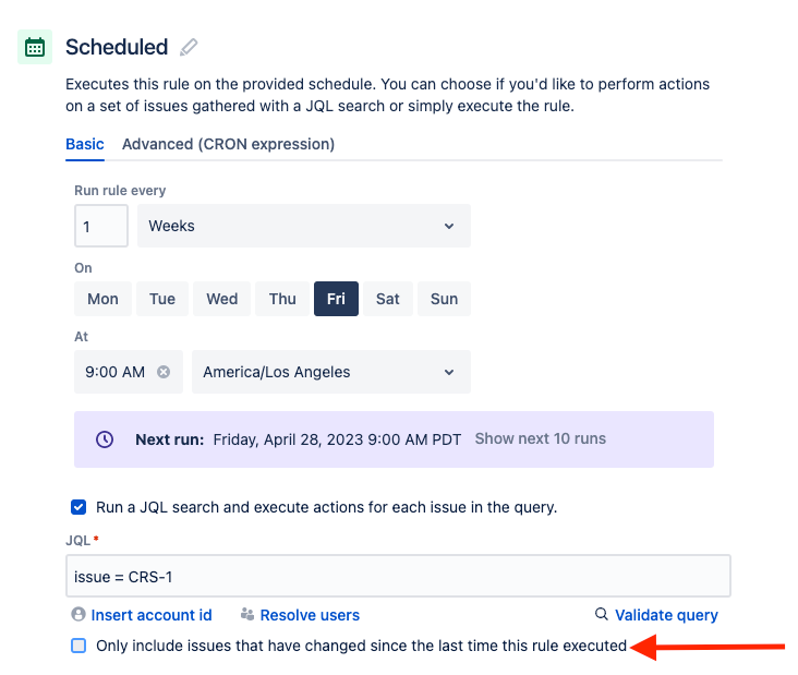

For testing, in your trigger you could set the JQL to select just one Epic. Make sure to uncheck the box below the JQL field.

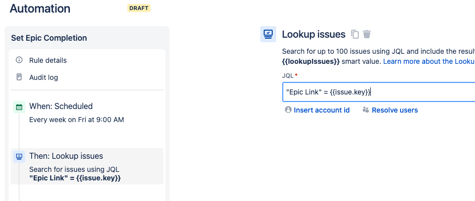

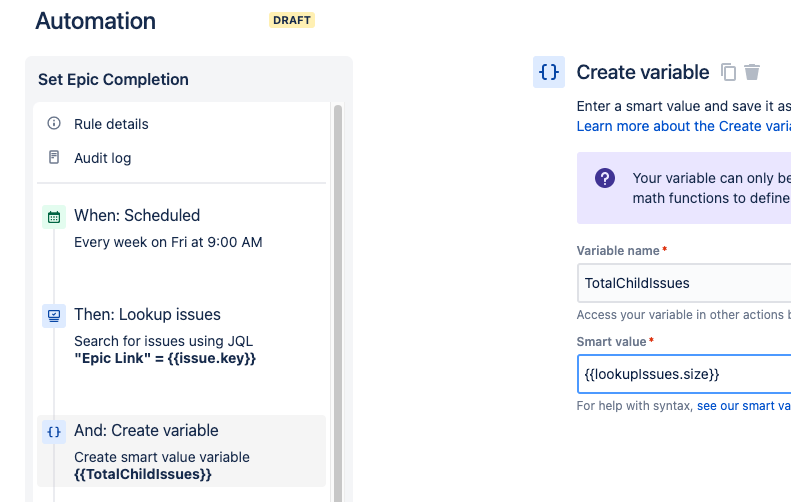

For the next step you would then use a Lookup Issue action to get a list of all child issues of the Epic, regardless of status. Use "Epic Link" if the child issues are in Company Managed projects. Use "Parent" if the child issues are in Team Managed projects.
Record the number of issues returned in a variable.

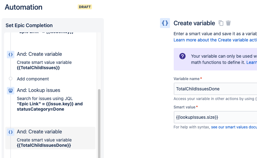

Then do another lookup to find just the Done issues and record that count in another variable.

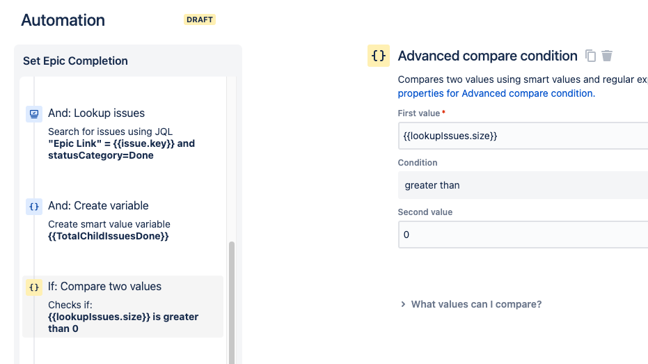

If the total child issues done is not 0

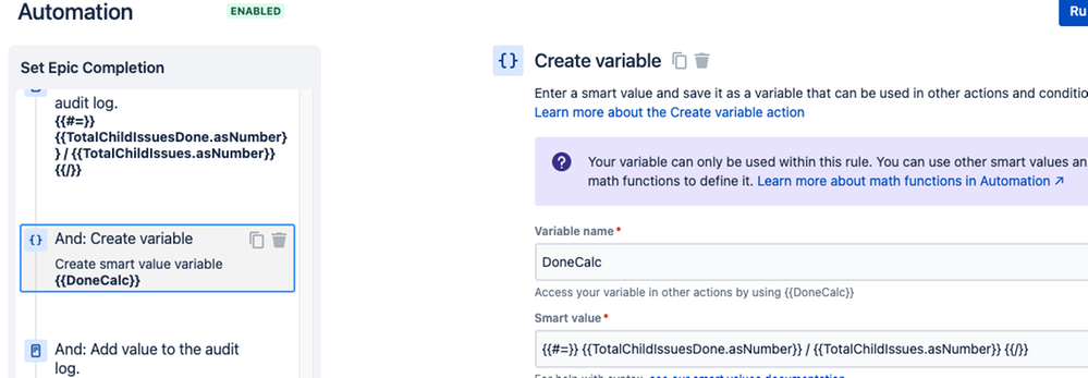

Create another variable to save the Done/Total value
{{#=}} {{TotalChildIssuesDone.asNumber}} / {{TotalChildIssues.asNumber}} {{/}}
Then you can express that as a Percentage using
{{DoneCalc.asNumber.asPercentage}}

When you include in the Schedule trigger a JQL statement to select issues, all the actions in the rule will then be performed against each issue returned by that JQL statement.
If you include the JQL to select Epics in the trigger then you don't need a subsequent Lookup step to retrieve the Epics.
