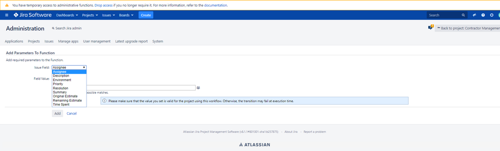

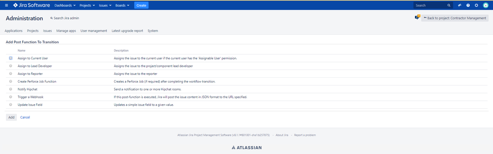

I have a problem with post function.
In "add post function" I do not have any option to update last assignee field.
In "Update issue field" I have following options
Please help me in updating last assignee field.

Hi @Tauqir Rao ,
I don't think you have either ScriptRunner or JMWe plugins installed, you would get the additional post function options once you install anyone of them.
