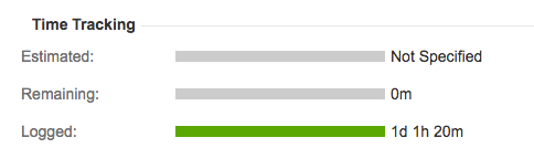

JQL does not calculate data the same way a SQL SUM function would.  JQL is a query language that will only retrieve data.  Please see the Advanced Searching Fields Reference for more information about what fields JQL can search.
In regards to calculating the time worked for each issue, the time tracking function will do that automatically when a user logs work.  Once they do that you should see something similar to the screenshot I attached:
Hopefully this helps!
