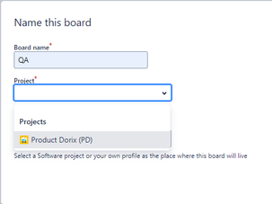

Hi,
I've configured a costume filter (it's working, I checked)
I tried to create an additional Board from an existing Saved Filter.
BUT it's not working for me. (it's not displaying the relevant filter.)Screenshot 2024-08-08 161545.png
I just want an additional board for the same project why is it so complicated this is so frustrating .
I just want an extra board like there
Please don't send me to read any more documentation the English is already hard for me

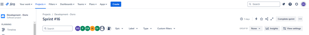

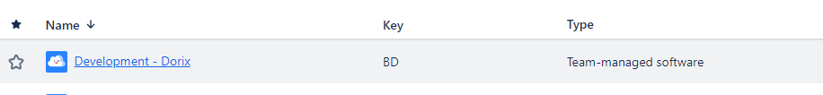

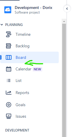

1. how do I know if this a Team-managed project or Company-managed project?
2. what top bar nav filter? I can't find what you're talking about. Can you please add screenshots?
Dorix dev
August 10, 2024
OK I think I found it's a team manage boardScreenshot 2024-08-11 085433ff.png
John Funk
August 11, 2024
Yes, it is Team-managed then. Also, you should see that it says that in the bottom left hand corner of the screen while you are on the board.

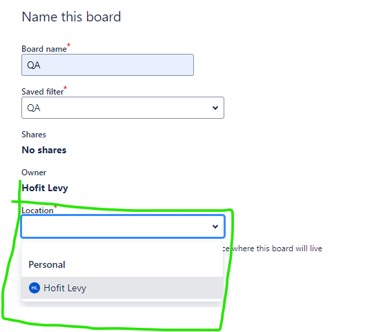

I saved the filter...
But it won't let me choose the project in the locations drop downScreenshot 2024-08-12 100711.png
Like John Funk likes this
John Funk
August 12, 2024
That might be because the Project is not a Company-managed project or is a JSM project. You don't need the Location populated with the Project name for the filter and board to work.

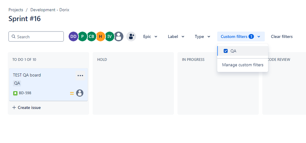

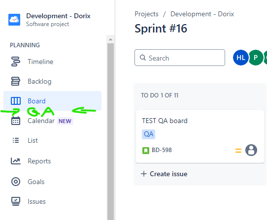

Dorix dev
August 12, 2024
But it's not board in the same project. it leads me do a different page.
I need the other team members to have access to this board.
Is it possible ?
I don't know if I didn't explain my self good.
What I want is:
A SECOND BOARD IN THE PROJECT. (this is a team-managed project)
I want it to look like this.
I know what I want.
Please don't try to find something similar or alike.
You know, it's very frustrating that for several days I've been looking for an answer in the documentation, looking in the community and getting answers that don't answer the question I asked.

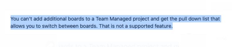

Out of desperation I asked people from my previous job and this is the answer they sent me.
If I had known this from the beginning it would have saved a lot of frustration.
"Not possible" is also an answer.
John Funk
August 12, 2024
You cannot create a second board IN a team-managed project. But you can do exactly what I said and it serves the purpose. The users have access and can click on the link in the left hand side just as easily has clicking on the drop down for the boards and selecting a different board. If back, it is one less click.

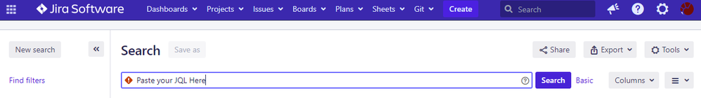

Dick
August 8, 2024
Quickfilters have their jql stored in the Board - Config location.
Just copy this jql and use it in the search for issues page accessed from the blue menu: issues
use the advanced jql representation and paste your quickfilter jql there.
Press SEARCH button, your issues will be displayed, then press SAVE
Now your filter will be accessible as a board filter in the interface you presented in the picture.
Dick
August 8, 2024
The search for issues page should look like this:
Like Aditya Ojha likes this

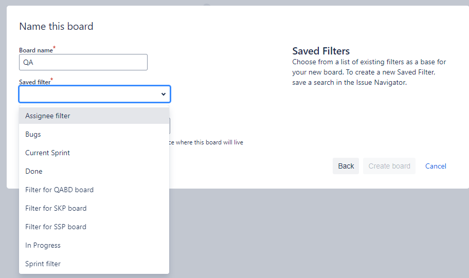

Dorix dev
August 10, 2024
Hi, so I do see the filter now! tnx.
BUT...I can't add a board to the specific project I want to add a board to.
The project I want to add a board to is called Development-Dorix  and its not visible as a choice
Dick
August 12, 2024
Hi Dorix,
The viewability of a board is set in the general section of the board configuration. Just add-in the development project users by giving them view access.
