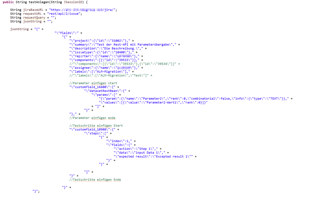

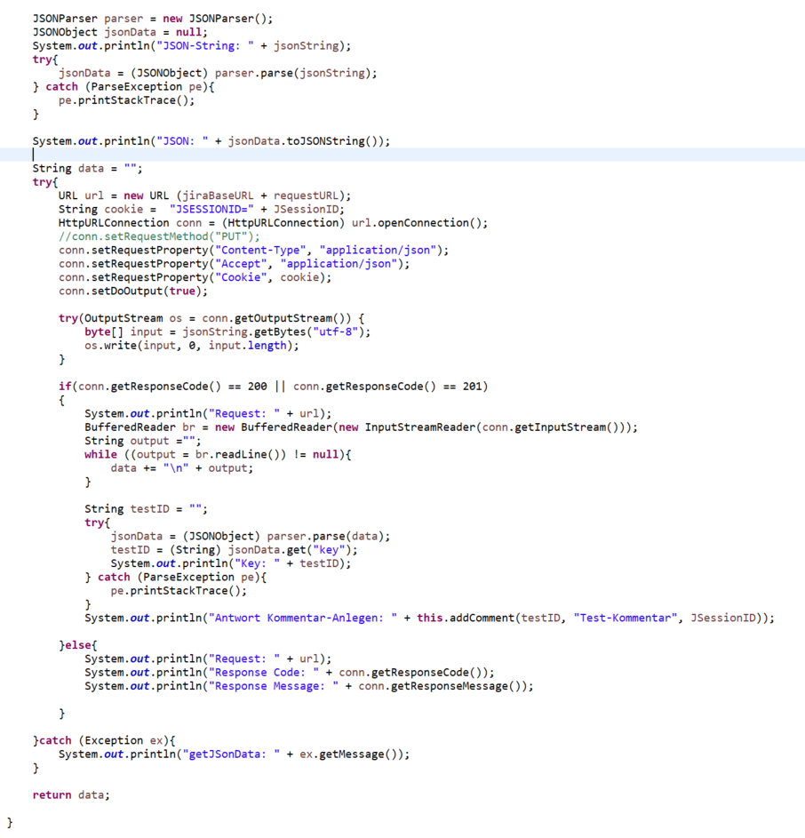

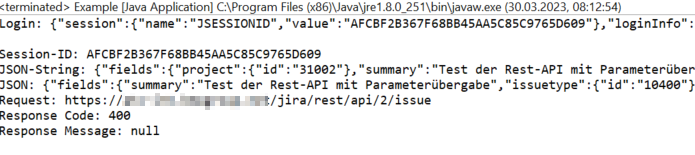

Currently I try to create a issue of type test with a params dataset.
The creation of an issue of type test without a params dataset works fine, but when I try to add the customfield for the params dataset I get an 400 as response for my request.
Unfortunatelly I can't find any documentation for creating issues with param datasets.
Her you can see how my request looks like and what the response is.
As I said the normal creation of the issue of the type test works normal and the issue will be created without anny error only if I add the customfield to the fields structure the error occurse.
JiraConnector_src_Example_1.pngJiraConnector_src_Example_2.pngJiraConnector_src_Example_3.png
hopefully you can help me with this problem, to solve it. I've also tried some variations of the customfield structure for the params customfield, e.g. with and without the datasetRestBean tag but it leads allways to the 400.

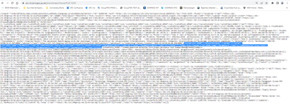

Here ist the response I get from an issue where the customfield is set:

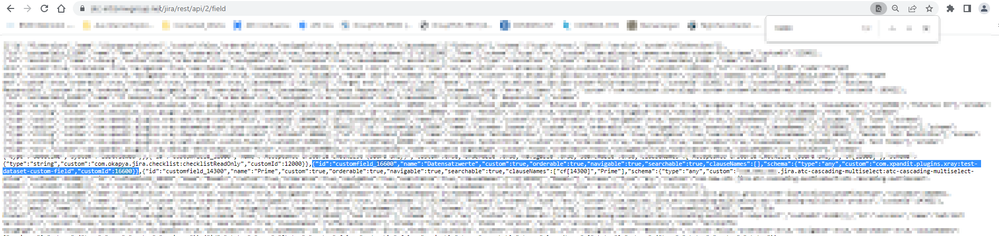

and here is the response whenn I'm request the general field definitions:

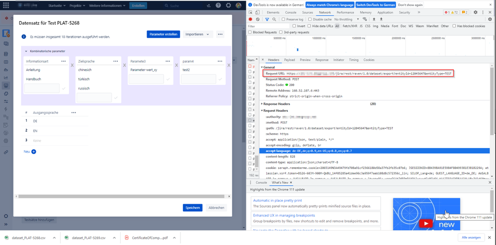

Yes, it seems to be as I have to use somehow the dataset import/export resquest to handle datasets for test issues.
The following request will be send if I open the issue in jirra and export an existing dataset:

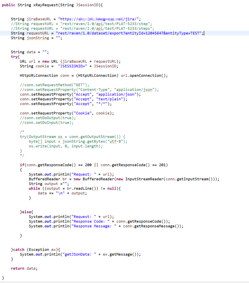

But when I try to use this request in JAVA I still get a 405:
In generell the rest api for XRay works. If I do the following request the response is correct and all steps of the test issue will be displayed.
String requestURL = "rest/raven/1.0/api/test/PLAT-5233/step";
or
String requestURL = "rest/raven/2.0/api/test/PLAT-5233/steps";
So something with the dataset export request seems to be wrong in the way I try to use it...
