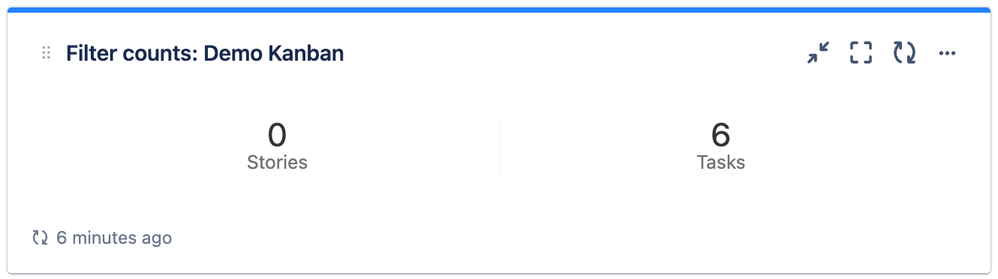

If you would only like to report on the current sprint, you could use the filter counts gadget to pull a couple of KPI's on the board, like in this (simple) example:
Stories and Tasks in the example are retrieved using separate JQL filters, so they more or less represent what you describe: pulling in data from 2 different filters into a single gadget.
However, as I mentioned above, the gadget does not allow you to display data of multiple sprints. If you want to do something like that, you would need to look into more specialised reporting apps. Integrated into Jira, EazyBI is definitely capable of doing this type of reporting. Or if you have a BI reporting solution in your company (like Tableau, PowerBI, ...), there's definitely ways to connect your data from Jira with those reporting solutions as well.

Walter Buggenhout
May 7, 2023
Good call out, @Bill Sheboy! No, it is not. But it seems to come with Jira Service Management. Since I have the entire Jira suite of products on my test instance, I did not think about the origin of the gadget.
