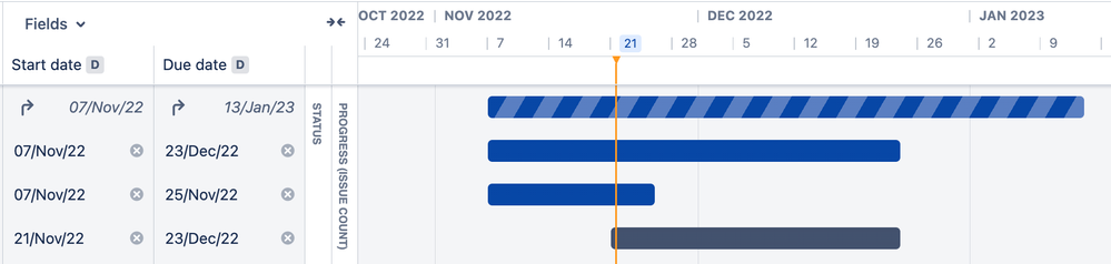

when you choose to roll up the date in advanced roadmaps, it is not set on the parent issues. It is calculated and displayed in the plan in italics. Also, the roadmap bars in your plan will be displayed using colour shadings, like this (the top item is rolled up, all other dates are set , manually):
The field that you are looking for to filter on, is the one you see in your plan. In my screen, it would be the due date. You should check what it is in your plan, but it is the same as the one you use on tasks.

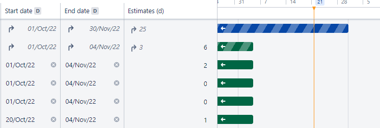

This is my screenshot (which is very similar to what you put in the answer, but in csv file you can see that for Initiative and Epic the "Star date" and "End date" are empty but the value is in the column "Star date (roll-up)" and "End date (roll-up)")

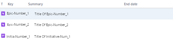

If I run the query "End date[Date]" is EMPTY AND project ="MyProject" these are part of results:
As you can see "End date" is Empty. I think that Jira save, I don't know where, the "End date (roll-up)" somewhere else.
