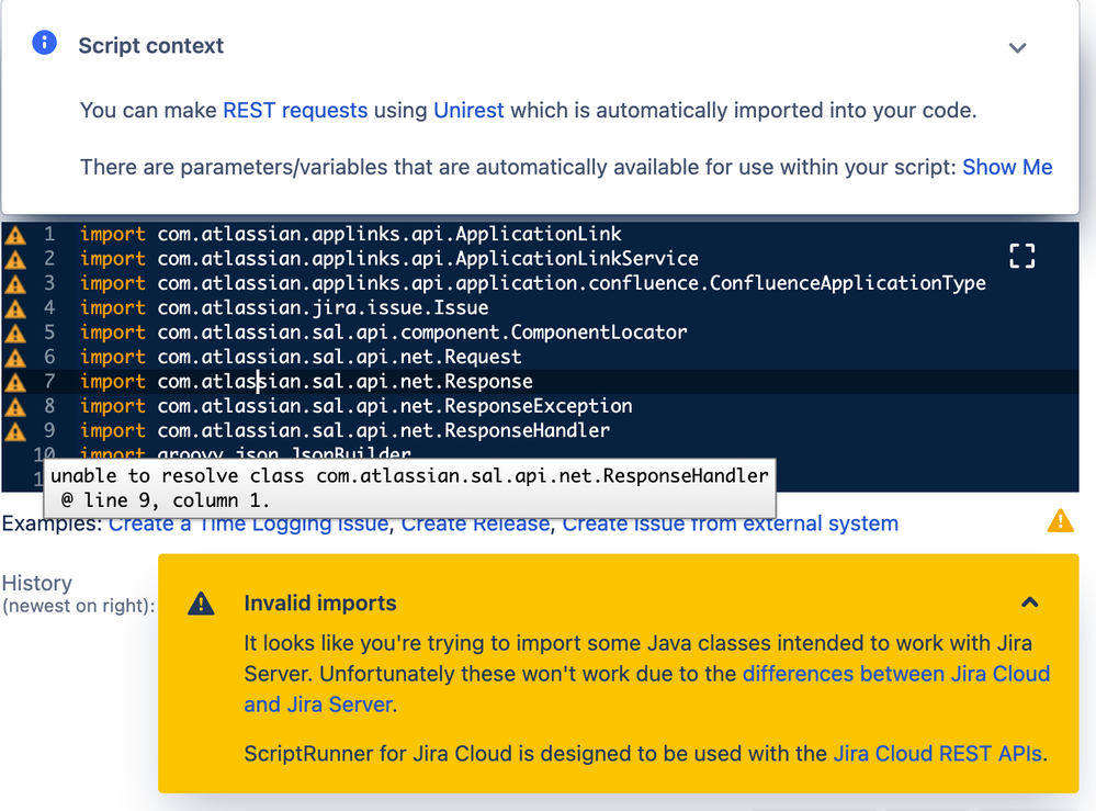

@Kate Kabir What I am trying to achieve here is to create a confluence page from Jira Scripttunner. The example here does not work for Jira Cloud. Can you point me the cloud version of the same example?
Jibu Chacko
January 24, 2021
Kate Kabir
January 25, 2021
Hi Jibu.
The link that you have provided is for Jira Server. This will not work in the Jira Cloud environment/integration. The information that I have provided earlier is for you to link to a Confluence page from ScriptRunner for Jira Cloud environment. The link that I have provided is specific to Jira Cloud integration.
The only way to achieve this, you will need to make a rest call to the Create or update remote issue link API which Atlassian provides and is documented here.
I can confirm we have an example of how to call this endpoint inside of the ScriptRunner for Jira Cloud documentation page located here which shows an example of how to add a link to an external URL.
I can confirm that you will be able to take this example and to use it as a reference guide and to modify it by updating it to set the globalId value which would refer to the page in Confluence as the API documentation page linked to the above mentions.
Thank you.
Kind Regards
Kate
