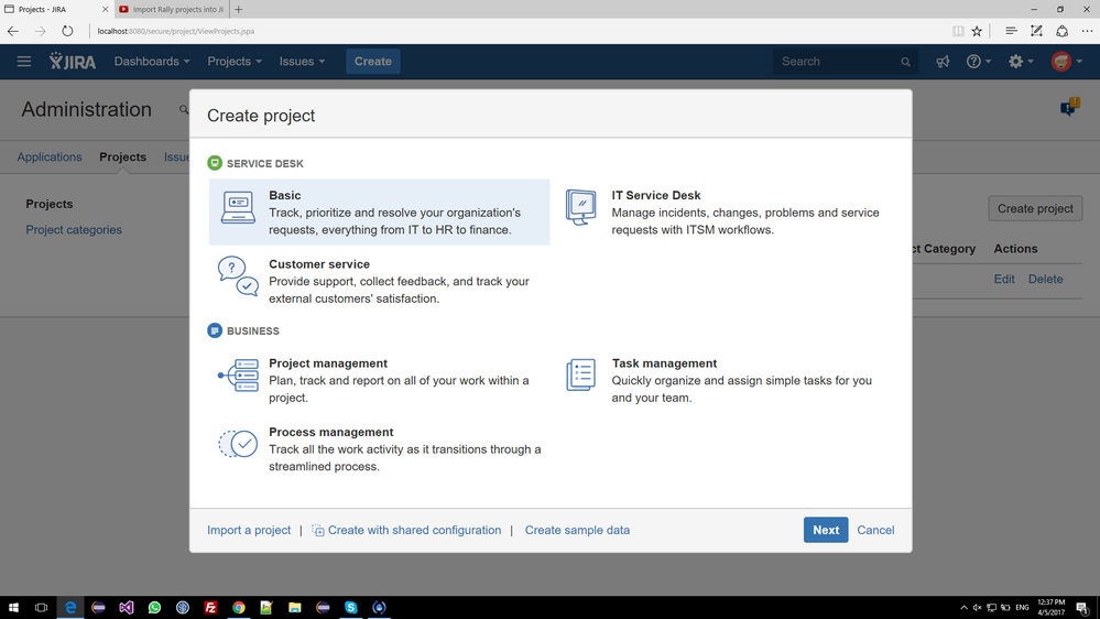

Hi lonut - What do you see if you go to JIRA Admistration (i.e. cog icon on top menu bar) > Applications > Versions & licenses?
Is there a heading there for "JIRA Software" and is it enabled?
Ionut
April 5, 2017
Waw..You are totally right. The problem was that I didn't paste de licence there.Huge like for the answer. I spent lot of hours finding a way to solve this. Thank you very much, Sam!
