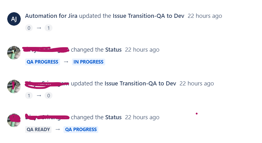

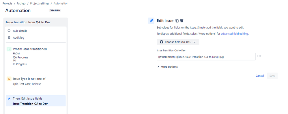

Hi @Trudy Claspill
I have done the same, I have to count the transitions as below:
QA Progress - Inprogress
In Review - Inprogress
But I doubt it since I am using the "In Progress" status in both the automation rules" QA Progress- In progress" automation rule is not working, It automatically goes to 0 and then updates to 1 irrespective of the transitions-So basically it remains in "1". Gone through the audit log but still shows success
But in the below screenshot, it indicates some error which we cannot identify

Hello @Divya Srirangam
Am I reading the series of events correctly...?
Part 1:
  • The issue was transitioned from QA Ready to QA Progress.
  • The Issue Transition-QA to Dev was changed from 1 to 0.
Part 2:
  • The issue was transitioned from QA Progress to In Progress
  • The Issue Transition-QA to Dev was changed from 0 to 1.
The rule that you showed appears to cover Part 2. That makes me think there is another rule that is causing the field change in Part 1, if it is not being changed manually by a user.
You can click on the Rule Executions field in the Details panel of an issue to see what rules have run against that issue to find out which rule may have caused that.
You mentioned that you have two starting statuses that transition to In Progress and you are counting both of those. There is nothing inherently wrong with that if it meets your needs. In fact you could have one rule that includes both of the starting statuses in the trigger. Is your goal to count how many times the issue transitions to "In Progress" regardless of the starting status? Or are you trying to separate the counting of transitions based on the starting status?

Trudy P Claspill
July 3, 2023
You appear to have a rule that does what was asked - increments a fields when a transition is made.
It sounds like you also may have a problem with your rule(s) that the field is getting reset to zero.
And you also made this statement:
Given that your questions are diverging from the original post, please create a separate post for your questions. Please post screen images showing the entire Automation Rules that you are running, and tell us how the results are not matching your expectations. Show the Audit Log details for the executions of the rules. And regarding the above statement, hover your mouse over the "i" icon to display the information message.

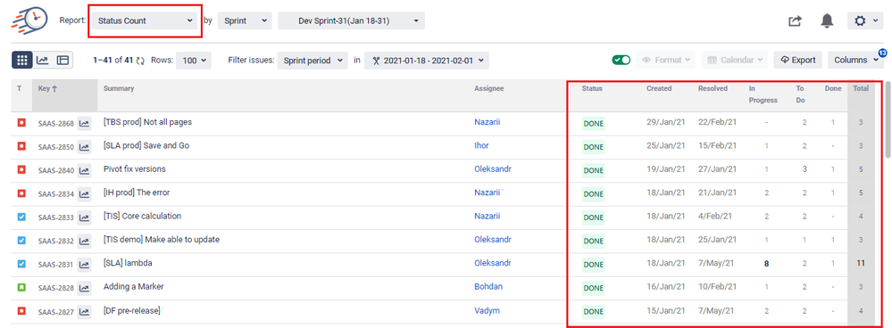

Hello @John Ricard
You can try the third-party add-on that my company provides - Time in Status for Jira Cloud. It generates 7 types of status reports, including Status Count report, that shows how many times an issue has been in each status
Also, you can export data from the grid to XLSX or CSV file, which you can analyze using such tools as Excel or Google Spreadsheets.
Hope you find it helpful.
Regards, Mariana

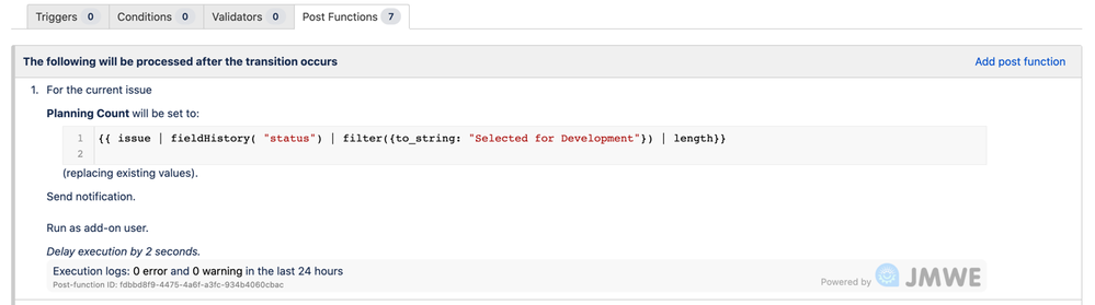

Hi @John Ricard ,

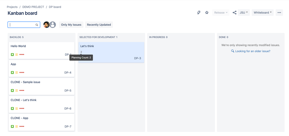

With the help of JMWE Cloud app you will be achieve your requirement. Please find below detailed steps.
  • Create a custom field of number field type called "Planning Count" and it to target project screen. Please add it to only view and edit screen of the issues.
  • Add the "Planning Count" field to Board issue detail view.
  • For the transition that leads to planning status, you can add Set Issues Fields ( JMWE) post function and select Planning Count as field with below sample code. Note below example has been shown "Selected for Development" status and you can replace the status name with planning.
    {{ issue | fieldHistory( "status") | filter({to_string: "Selected for Development"}) | length}}
  • So whenever you make transition to planning status, value will be set with help of JMWE post function.
  • Also please find below screenshot of kanban board.
Thanks,
Avinash

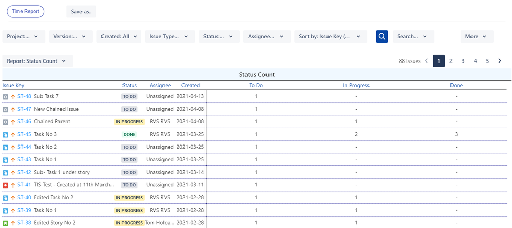

Hi @John Ricard
For a readymade solution, to get this data you can try out our app.
Time in Status Reports
The add-on provides the time in each status for the entire lifecycle of the issue and you can filter by issue type as well. You can also combine your statuses to define your lead/cycle/resolution time and also extract the transitions history of the issues. The main features of the app are as below
  • More than 8 types of Time in Status Reports. Excel Export available for all status reports.
    • Time in Status
    • Time with Assignee
    • Time in Status with Assignee
    • Time with Assignee per Status
    • Status/Assignee Count
    • Multiple Transition Reports
    • Avg Time in status reports
  • Status grouping
  • Save your reports
  • CSV Export
  • Multiple chart types
  • Dashboard Gadget

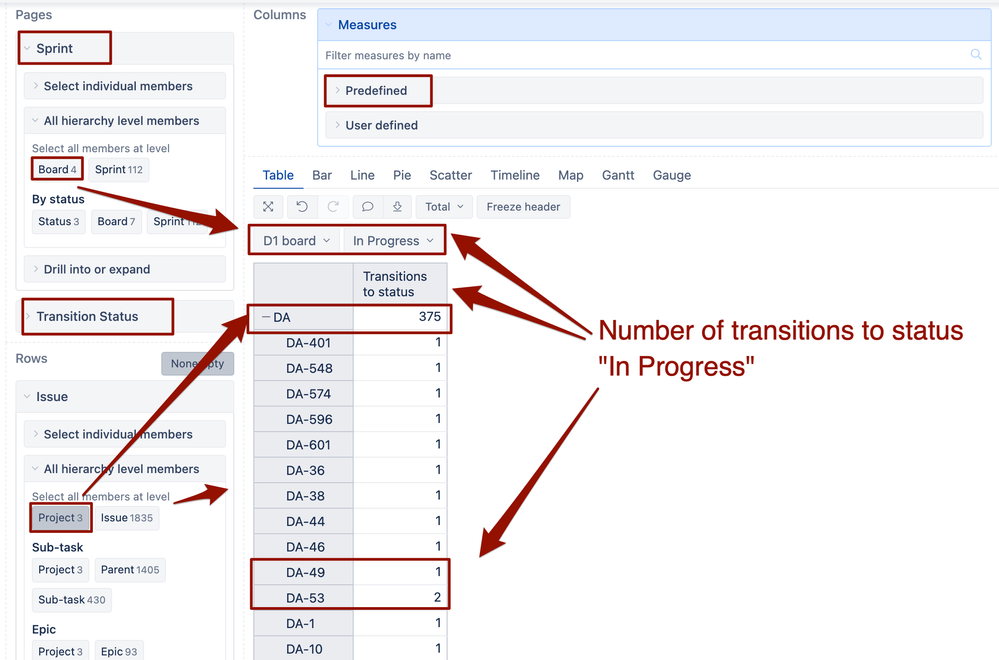

@John Ricard
You might want to check out eazyBI app for custom jira reporting.
It can be used to calculate the number of transitions to a historical status and show that for all issues in the board and per issue. Also you can add "Time" dimension to filter transitions in time.
Martins / eazyBI team
