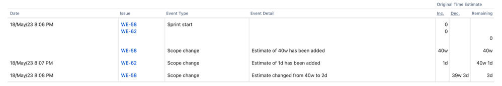

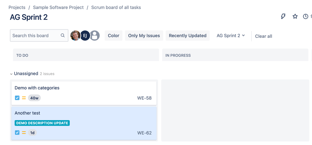

A few screenshots from my test. First: created a sprint and added an issue with a ridiculously high estimate.

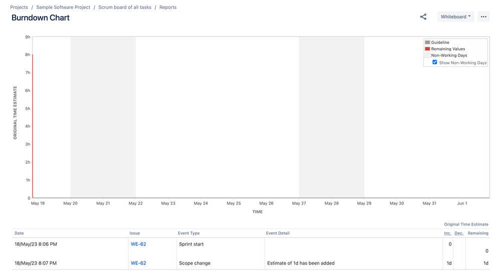

Then updated the estimate to a much lower value, which then is reflected in the burndown chart and the history table below. The very high estimate is still in the chart:
Then I deleted the issue, bringing the chart down to normal proportions and erasing everything from the issue history:
