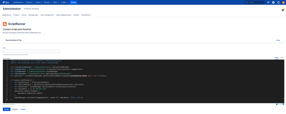

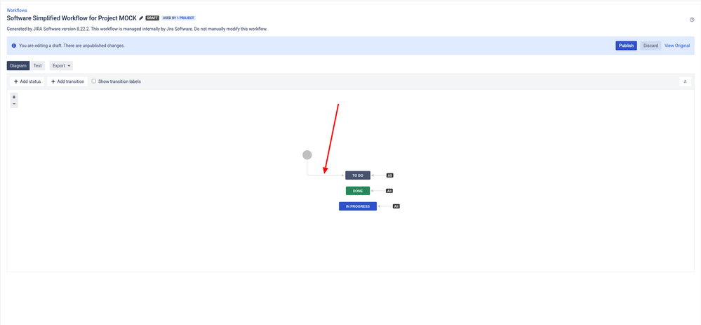

For your requirement, you will need to use the Post-Function for the Create transition as shown in the screenshots below:-
You will need to include a new Post-Function. From here, you will need to select the custom script post-function [ScriptRunner] as shown in the screenshot below:-
Once you have selected it, you must include the custom code.
Below is the working sample code for your reference:-

Please note that the sample code provided is not 100% exact to your environment. Hence, you will need to make the required modifications.
Below is a screenshot of the Post-Function configuration:-

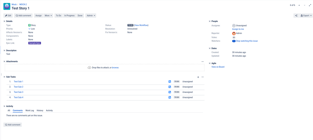

2. Below is a screenshot of the Story with no labels in it.

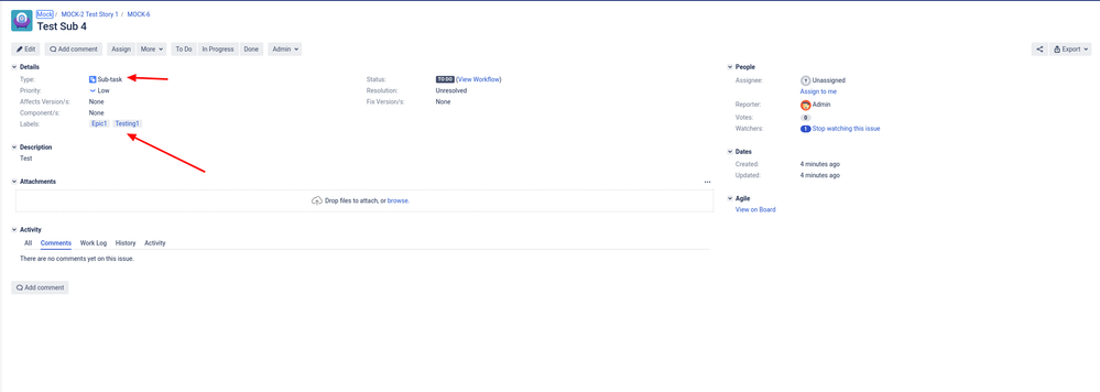

3. Below is a screenshot of the Sub-type issue that has copied the Epic labels.test3.png
