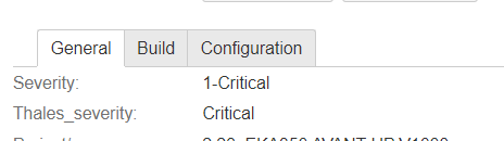

have a project in Jira, let's call it Project A, which contains 15 issues. I need to copy or export/import these issues to another project, Project B. However, after migrating the issues, I've noticed that some fields are missing. Here’s a screenshot showing the missing fields:
Project A.PNG(Project A having tabs and fields also but once move or copy or import the data to Project B tabs and fields are missing)Can you suggest best way to migrate the issue.

I tried both way,but Once Migrated all issue ,tabs and field are missing in all issues.Is there any way to fix this issue

How are you importing the issues? Are you using a CSV import? Such a process will not create tabs and fields in the destination project. Those have to have been already set up in the destination project.

Using CSV Import, First I create a destination Project with shared Configuration of Source Project. and then Import data into Destination Project.Once done these tab and field are missing ....and also I tried Bulk Copy Issue also.....is this issue with screens or now need to manually update the fields in issue or any options or suggestions.
