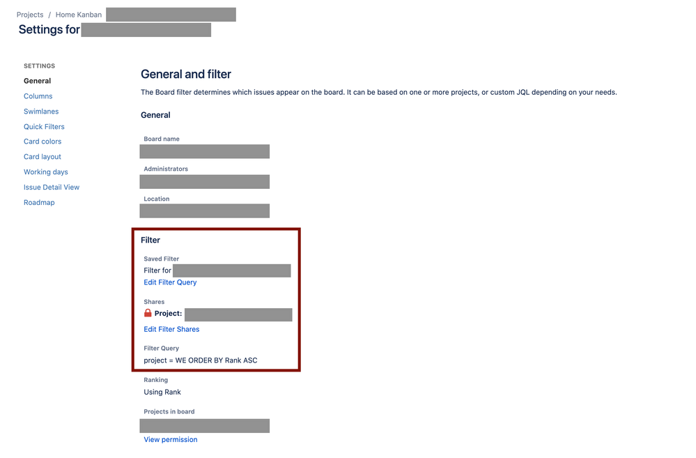

Hi @Lucia Balen,
When you copy a board, you also copy its settings. And one of those settings is the filter that fetches the issues of your original board. You will be able to verify that by going to Board Settings, where - on the General tab you will find the board filter:
It is by replacing the board filter with a different filter (one that fetches issues from a different project or projects) that you will be able to view different data on your board.
