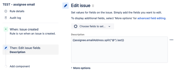

Automation can do this, though. You'll do what I mentioned above, but the "Edit Issue" action is just a pinch more complicated.
I created the rule below to test it. This rule copies the assignee email address domain (everything after the @ in the email) to the Description field. You'll want set it to your custom field instead.
I have the action component selected in the rule so you can see the Smart Value notation used to extract the email address and parse out the domain.
Screen Shot 2020-12-09 at 5.14.57 PM.pngImportant notes:
  • If the assignee is blank, the domain will also come back blank.
  • I'm not sure how you're assuring that the Assignee is set when the issue is created. If this automation runs BEFORE the Assignee is set, then the rule will appear to succeed, but the domain will be blank.
  • You might also consider a second rule to trigger this same action when the Assignee field changes. I assume you'd want to keep this custom field in sync, in case the issue is reassigned.
  • The 100 rule executions per month limit on the Jira Free plan is still in play here.

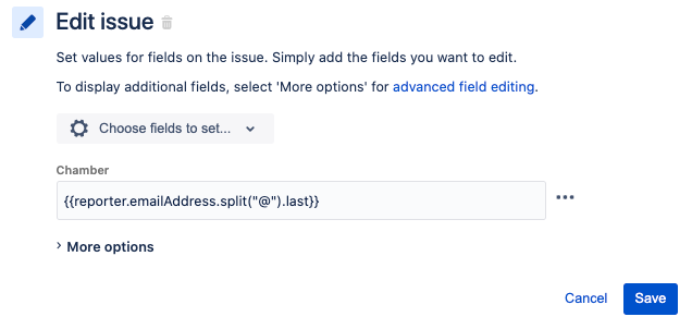

Mykenna Cepek
December 10, 2020
So the SmartValue syntax (the code between the {{ and the }} markers) should not be in the "Additional Fields" section (under "More options"). Only JSON belongs there, and that is the source of the error.
Instead, put the SmartValue code into the "Company2" field. We don't want to clear that field, we want to set it to the value returned by the SmartValue code.
It should look like the following. I used a field we had called "Chamber", you want "Company2" there, of course.
Screen Shot 2020-12-10 at 9.28.30 AM.pngImportant notes:
  • Be sure to remove the changes made under "More options".
  • This approach assumes that the "Company2" custom field is a Text Field. If not, let me know.
