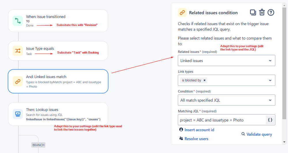

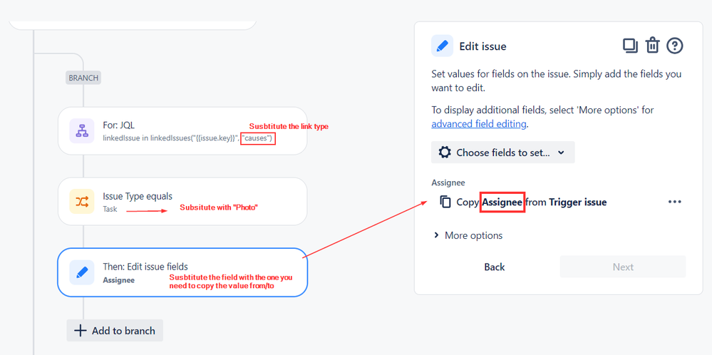

If I understood correctly you want to copy the value X from the issue type "booking" to the issue type "photo" when booking is transitioned to the status "revision".
You'll need to identify which link type you're using and adapt this automation:
The scope would be multiple-project.
I would say the linked issues match is optional but recommended if you want to limit errors.
Hope this helps.
