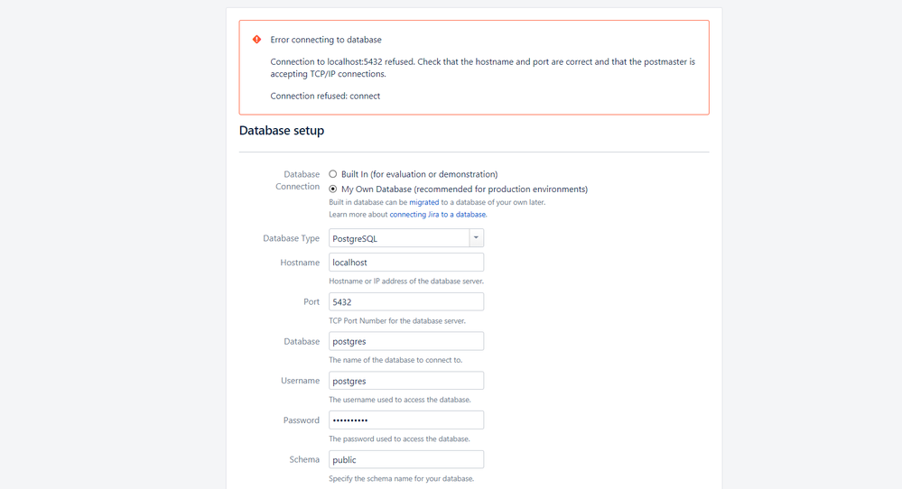

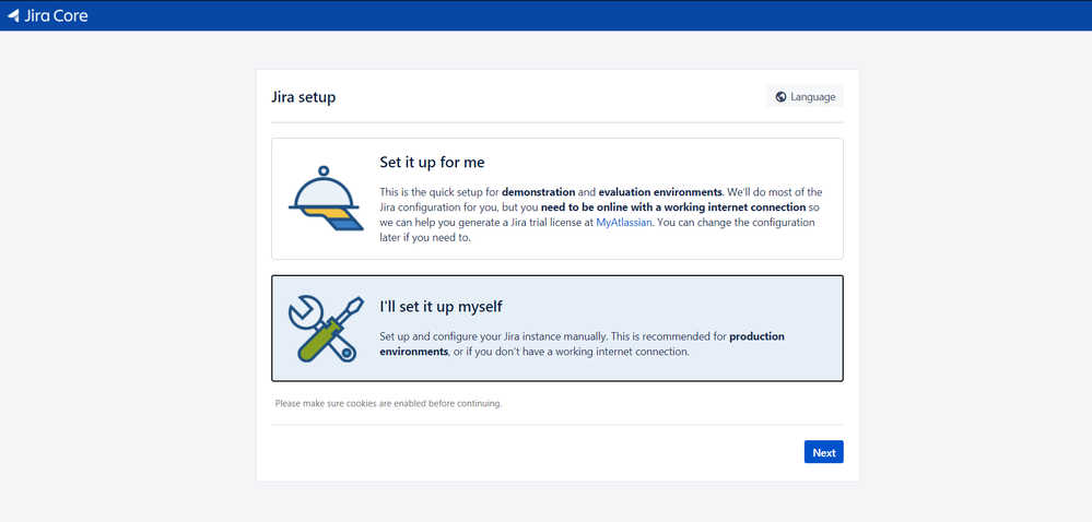

Note: I have also installed jira software as service to my laptop. When go to localhost:8080 i can see the figure 1 and when i click "I'll set it up for myself" figure 2 comes and i fill them as my database created on the other pc. When i test the connection it pops an error.
1.PNGFigure 12.PNGFigure 2

Your second question is about connecting the server to a database - you have not completed the setup of Jira yet, so there's no point looking at the url or remote access yet (you could, but you'll get the same results).
It cannot connect to the postgres database you have told it to use.  This could be any number of things, but, in my experience, 5% of the failures I've seen are "our network does not allow traffic on the port postgres is listening on (default 5432)" and the other 95% are down to /etc/postgresql/<version>/main/pg_hba.conf disallowing the connection.
I'd start with a look at the local access to the database, and once that works, look to remote.
