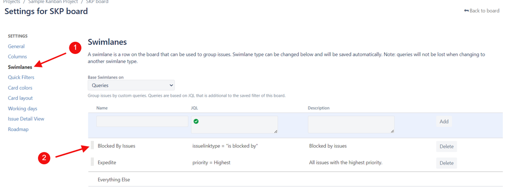

I need to organize swimlines showing the 'is blocked by' issues in it. I think, we need to define a JQL-Querry to filter the 'is blocked by' issues to the issues in the project.  (Scrum board, all issues belongs to the same project)
The main point is, I don't know how to filter the 'is blocked by' issues, i.e. how to define a JQL for configure the swimlines with that query.

Hi Roberto,
Are you using a Team-managed or Company-managed project? If Company-managed, I would just use a Quick Filter on the board instead of a whole swimlane, but that's up to you.
Try this: issueLinkType = "is blocked by"

Hi @Roberto Luis Rodriguez-Estevez
try to create a swimlane in board settings using the query provided by @John Funk and it should work.

Yes, it works. However, the board shows all Issues having 'is blocked by' in one group (swimline).
It would be better if there was one group per issue, with the link 'is blocked by' and below that the linked issues (the blocker ones).

Issues can only appear in one swimlane. So if the issue meets the criteria of multiple swimlanes, it will appear in the top listed swimlane. As mentioned above, you are better off using a Quick Filter for the blocked issues versus putting them in a swimlane.
