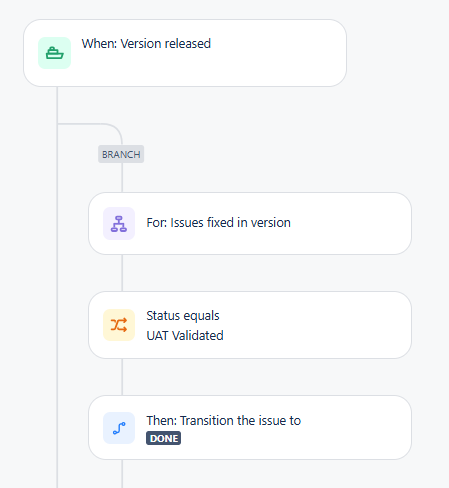

Hello, I'm trying to configure an automation rule that transitions the work item from UAT Validated status which has Resolution already set to Done status with Resolution set. I keep getting this error:
(The selected resolution cannot be chosen during this action. (resolution))
I've tweaked the rule many, many times and have also:
1. Ensured atlassian-addons-project-access has every permission in the project's permission scheme.
2. Ensured there is a transition in the workflow from UAT Validated to Done.
3. Removed the transition "Resolve Issue" screen altogether.
4. Added the Resolution field to the screen.

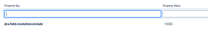

5. Explicitly included the Resolution id 10000, which is the Done resolution ID, on the transition Properties.
6. Tried a bunch of different rule configurations, including:
6a. not specifying any rule for the Resolution field
6b. on the "Then: Transition Issue Status to Done" step I tried choosing the Resolution field to set to Done, also tried not choosing the Resolution field but instead put the below in the Additional fields text box, and also tried not choosing the Resolution field but instead put the below in the Additional fields text box using "name": "Done".
          "fields": {
            "resolution": {
              "id": "10000"
6c. separating the transition step and editing Resolution step, and changed the order to have Resolution first and then tried Resolution last
6d. adding a condition that the Resolution is resolved
I just don't know what else to try. This should be pretty simple, I think.

Does the transition include workflow properties that prevent the value you try to set ?

Originally, the workflow transition from UAT Validated to Done properties were empty, but to try to make it work I added it explicitly. Still didn't work.

You do not need the workflow property, it's sometimes used to include/exclude some resolution option during the transition. In your case it could have block you if the 1000 resolution was excluded.
Right. The transition properties definitely didn't and don't exclude the resolution, and I tried explicitly including the resolution, which didn't work. I just removed the inclusion and tried the automation again, and it didn't work. So, the properties don't seem to be the problem.

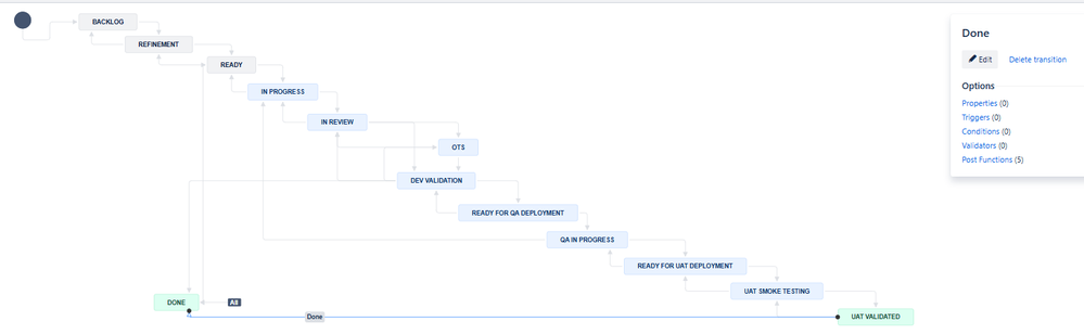

Can you add a screenshot of the Transition action ? As well as the Condition/Validator/PostFucntion of the transition itself in the workflow ?
Stewart_ Emily _ Global D_T
March 28, 2025
Sure. There's really nothing much to them. As I mentioned above, I've tried the automation transition many different ways: (1) without any Resolution field, (2) with choosing the Resolution field and resolution value, (3) with Resolution id and value in the advanced edit, and (4) with Resolution name and value in the advanced edit.
