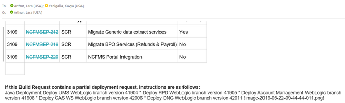

Ok, so....I've got a scriptrunner post function email set up to let our Testing team know that the build is ready for testing and that there are defects included that need testing.
I've got no problem pulling the custom field "Fixes Defect/s" (highlighted in screen shot and created as a scripted Issue Picker field) but would like to list them and provide a hyper link as I have with the baseline issues (ie RMT-501 & RMT-499)...see below.
Scriptrunner email.JPGIs this possible?

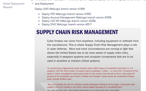

What I'd actually like it to pull is exactly how it shows up on the ticket itself:
And see this rich text format transfer from ticket to email
Instead of looking like this:
