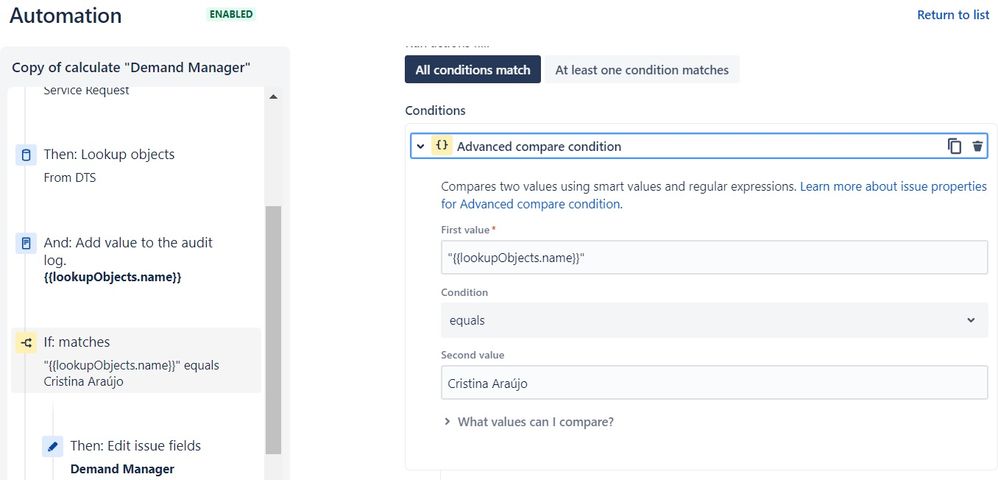

Hi,
I need to compare a value (eg. Mary) with a lookupObject using automation.
I tried to do many things, but didn't work.
       First value: {{lookupObjects.name}}
       Condition: equals
       Second value: Mary
I know, {{lookupObjects.name}} is Mary, because i put "Add value to the audit log", before "Advance compare condition" and show me "Mary".
Could you help, please.
Thanks

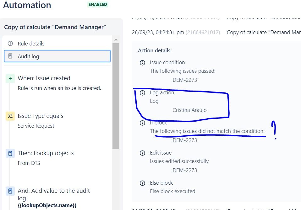

Sara Silva
September 27, 2023
Hi @Bill Sheboy
Thank you for your words.
I don't understand, why the "issues did not match the condition".
Thank you,
Regards
Sara
Bill Sheboy
September 27, 2023
Thanks for that information, and...
In your compare, I note that you have quotation marks around the smart value.  Please remove those and test again.
Otherwise the "second value" will not match as it does not have quotation marks around it.
