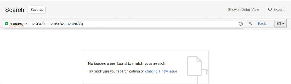

The function 'issuekey()' does not seem to work form me. Please see the attached screenshot.

Odd. Do the following work?
issuekey = FI-198481
issuekey In (FI-198481)
Lawrence
May 14, 2019

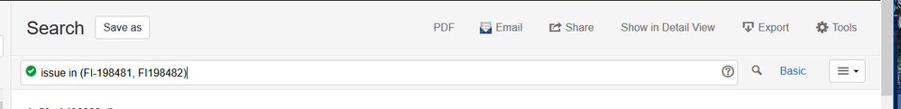

Neither of them works. With luck, I see the following work:
         issue = FI-198481
         issue in (FI-198481, FI-198482)
But, I cannot find the ellipses in the top right? What else did I miss here? Please advise.

shetty
May 14, 2019
Click on tools,you will get option to bulk change, if not please make sure that you have global permission to bulk change issues, if you have the permission then you will be able to
Lawrence
May 15, 2019
Yep, that works. Thank you, Ramesh,
Also, thank you Jack for providing the detailed step by step procedure to bring up the bulk editing feature and the idea on troubleshooting the initial issue that I encountered.
Kind regards,
Lawrence
Jack Brickey
May 15, 2019
yep you are on server where the tools cog replaces the ellipses in cloud. It is odd that Issuekey doesn't work in server. both work in cloud and issue should be an alias for issuekey.
