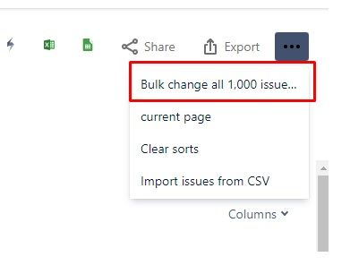

What you are looking for is the Bulk Edit option. In the filter you just created, in the upper right corner, if you have the correct permission and have a standard or better plan, you will see the option Bulk edit. It is fairly straight forward, let me know how it goes.

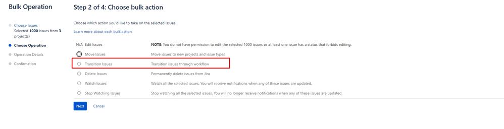

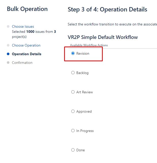

The Bulk function is a bit confusing at first, in Jira when an Issue is move from one status to another, for example from Open  to In Progress it is refer to as a Transition .  Said this, I see you selected "Edit Field" in step 2. Since your objective is to Closed tickets you want to select the option, Transition Issue, see picture below:
Than you can select the Initial Status of the Issues

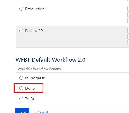

And the destination Status for the issues, in this case Done.

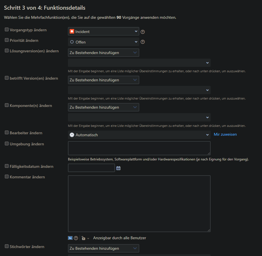

Hi Nico, thank you so much, I got a bit further, but now I am stuck at step 3, where I don't know where to find the option : close all tickets with same comment: (which one is correct?)
