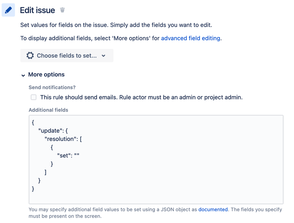

Martin Bayer _MoroSystems_ s_r_o__
September 2, 2022
Hi @Chris Robbins , welcome on the community. I'd suggest you to use the workflow's postfunction to set or clear the resolution (as @Alex Koxaras -Relational- suggests), but if your use case requires to use the Automation, you need to do it using following setup. Let me know if you need more help :)

Marc Isikoff
June 23, 2023
Does not work:
(Could not find valid 'id' or 'name' in resolution object. (resolution))
Now the post function is not an option if we have no access to edit it (by rule of company)

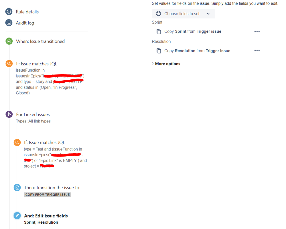

I have a similar situation. Linked issue inherits Status & Resolution from Linked Story
and it is fails with error
Our workflow does have
Clear Resolution post-functions on Open and In Progress . And Resolution field screen on Closed Transition with a Validator of Resolution field being required.
Any suggestions?
Nic Brough -Adaptavist-
May 25, 2024
Get rid of the validator on the close transition, you do not need it.
Then reverse the two actions for "edit" and "transition" - you need to set the resolution before you transistion.
Like Suresh likes this
Suresh
May 27, 2024
@Nic Brough -Adaptavist- You are the best. I retained validator to skip it for Test Issue type and your solution of swapping edit and transition worked. Resolution has to be before Transition.

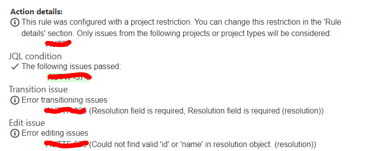

Daniel Sanchez
August 21, 2024
Hi Suresh, Does it work for you changing resolution to null? I have tried similar solution as exposed but always having same result:
Error editing issues
Transitioned issues to Open
