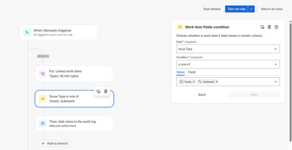

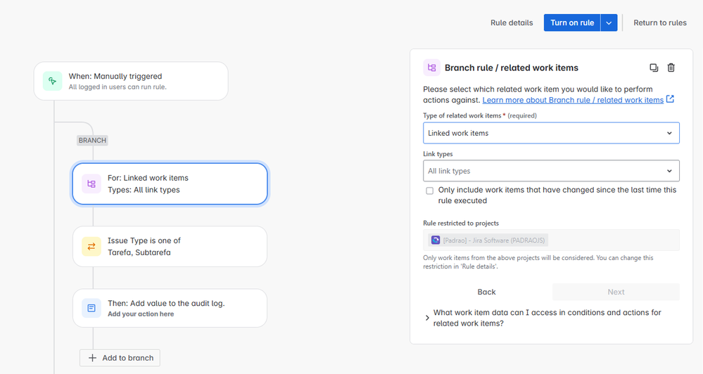

You can do this using the following automation blocks:

Deivid Araujo
May 27, 2025
In that case, you can just change the "Condition" field from "Is one of" to "Is not one of".
