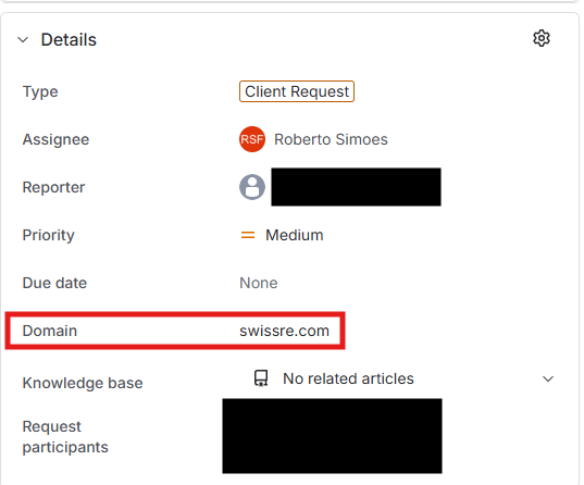

I have a field that contains the requester domain, for example @jdoe.com and I would like to create an automation that, based on a list of domains will edit another type (drop-down).

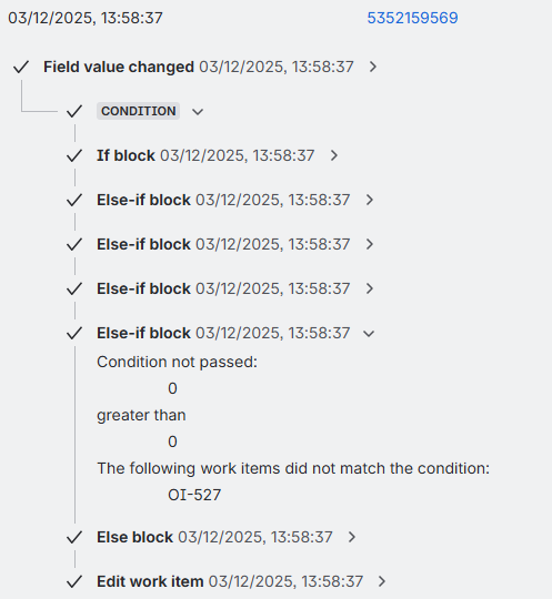

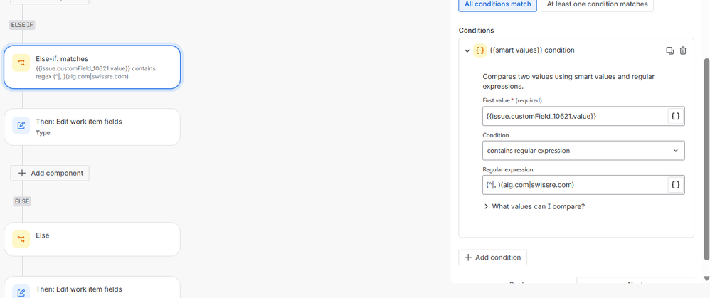

I've checked all nodes in the logic and all work fine, except this one, as I believe the way I set it up is not correct.
First, smart values are name, spacing, and case-sensitive. When an incorrect one is used, it returns a null value, sometimes collapsing an entire expression to null.
Your condition shows customField_10621 and that should be customfield_10621, in all lower case.

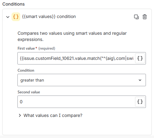

One way to diagnose automation regular expression problems is to use the match() function with the expression and write the result with the Log action.
From what you show...
I am guessing that field is a select-option field because you use the value attribute, leading to a list, and because this is a regex check, it creates an implicit text string as if you added join(", ") to the end.
Thus, this would be another way to check that is using the list value iteration and match():
This uses size to count the matching values, with a default count of 0, only passing if at least one is found.
