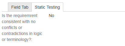

I have created a Single select custom field and able to modify the width of the label by writing code in the description of the field. But the issue is, when i try to change the options from the single select drop down again the label width going back to normal position and refresh is required to change the width again.
Is it possible to make the width of the label static when there is change in options?

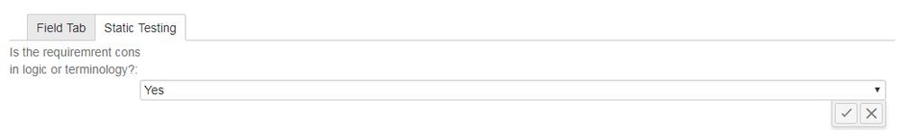

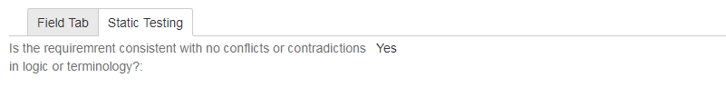

Sridevi
August 23, 2018
Below is the screenshot of the view screen after applying the code. Width modified as expected. Value - Yes
Below is the screen when i want to change the value and click on options
Capture_2.PNGAfter changing the value from the drop down, see the below screenshot width is back to normal size

Sridevi
August 23, 2018
Ho great!! it is working.

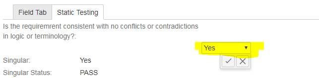

Only one issue is there. When i can click on the edit of options, drop down is expanding and coming to the next line as below.
Nir Haimov
August 23, 2018
Get the element of the dropdown, and reduce it's width
Sridevi
August 31, 2018
Hi Nir,
Sorry for the late response.
I have reduced the width and changed the position too. But if i click on edit, options drop down coming to the next line. Capture.PNG

Nir Haimov
September 3, 2018
Sorry,
i used your code and for me it works good.
so i don't know why it happens to you.
just try to play with the CSS for the elements
Sridevi
September 3, 2018
Hi Nir,
May be you have tested with single line label or short label. If it so, code works. If width of the label is as given in the code then the drop down is jumping to the next line after click on edit of the drop down.
Thanks,
Sridevi.
