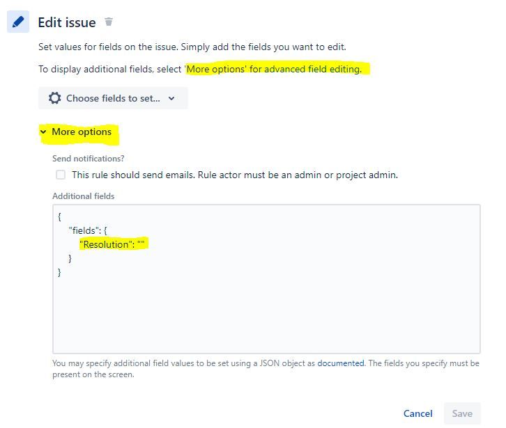

Paulo Giovanni Rosario
November 18, 2022
Hi,
If you think to do it using JIRA Automation, you can use this way.
A good tip: With this action RESOLUTION DATE will be clear together.resolution.JPG

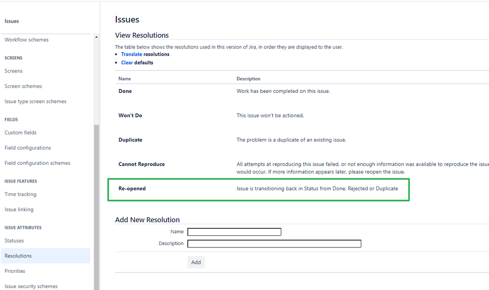

Wilbert Bus
January 3, 2023
Hi all,
I have tried all the different proposed solution for the automation, but nothing seemed to work for my situation.
I did find another approach which seemed to work in the end for me.
I created a new Resolution: "Re-opened" in Settings > Issues > Resolutions

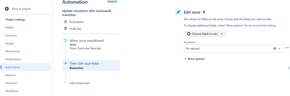

And then I created a new Automation rule by going to Project Settings > Automation
Trigger: Issue Transitioned
From status: Done, Rejected, Duplicate
+ new component
New Action: Edit issue fields
Choose fields to set: Resolution
Value: Re-opened2023-01-03 11 22 55.png
Hope this helps who are in the same situation

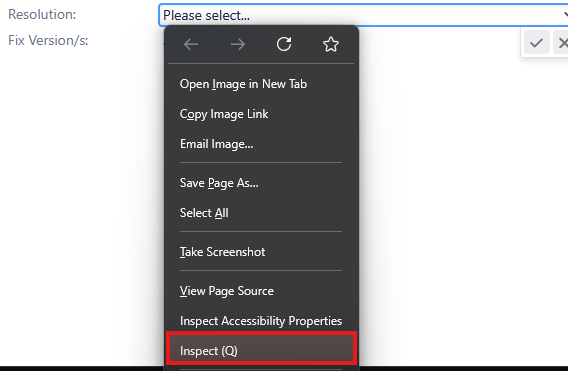

royalardor
September 9, 2025
For anyone else looking for a quick fix in the future like I was; I figured out a trivial/simple solution if you need to just manually change it back quickly.
You can just inspect the resolution dropdown element by right clicking on it, then changing the value of any of the drop down options to value="" or value="-1" then submitting it.
In the case above, I changed the Done option from value="10000" to value="", then I submitted the 'Done' drop down option; It worked for me.
