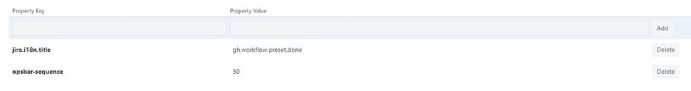

You can add the opsbar-sequence to the transitions properties to define the order it should appear in the list.  The lower the number the higher it appears on the sequence.  This is done by editing the workflow and will only work on company managed projects.
