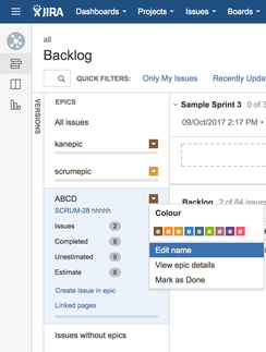

If this doesn't help, could you let me know how you renamed this epic?  Did you rename it in the way shown in this screenshot?
