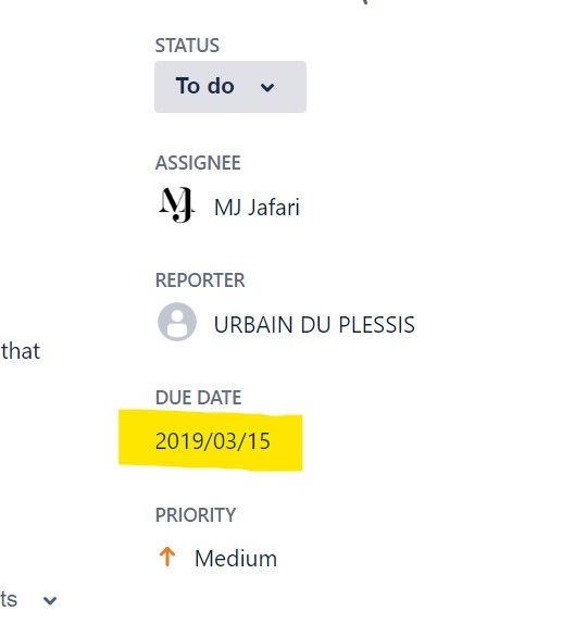

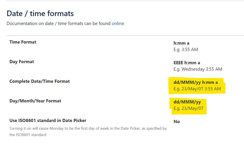

How do I change the due date format in JIRA core cloud? I have checked the look and feel under the system setting , it has the correct format but for some reasons, it doesn't apply to the issue Due date
Hi Angelica , please see the the attached screen shots from the issue due date and also the look an feel setting , we are using JIRA Core Cloud

This issue that you are facing is a bug and it happens only on the new issue view.
If you disable the new view (Profile picture > Personal settings > Jira Labs) and open the tickets through the Issues and filters > Search issues, you will see the date correctly.
