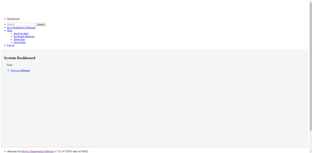

Hi Daniel. Thanks for that info. That helped loads!!! I do eventually want to configure SSL but I'm taking this one step at a time. I am now able to connect to JIRA with the right URL but now my site looks like this. Any ideas?

Hey Jessica,
Did you happen to restart Jira after making changes to the server.xml file? I just noticed that the documentation doesn't instruct you to do this after changing the connector. Sorry for not mentioning that!
It also is probably unnecessary but never hurts to do an iisreset /noforce after changing the IIS configuration as well. But I have a hunch that the problem you're seeing right now is related to Jira needing a restart.

Hi Daniel,
Yes, I restarted Jira multiple times. Every time I do get the "initializing" screen which gives me hope because it does look pretty (lol) but then when the app loads it looks like it's not loading the CSS. I did notice that in the instructions it said to turn off caching in IIS and I'm not sure why. Do you think that may have anything to do with it? In any event, I'd like to leave the iisreset as a very very last resort as I have other apps/sites running on that server as well that I'd like to not interrupt. Any other thoughts?

Jessica Torres
August 8, 2018
To give you a little more info:
I started reading this article because I felt it was relevant: https://confluence.atlassian.com/jirakb/jira-css-and-javascript-appear-broken-on-iis-847754118.html
And it suggested to increase the maxUrlLength to 1024 in the web.config, which I did to no avail. I opened the Developer Tools in Chrome and I saw a lot of 503 errors. Then I did a hard refresh and they cleared right up. All except one. It was a batch.js file and the length of the url was 1099. I was also getting this pop up:

In any event, I increased the maxUrlLength again, this time to 2000. The helped load the page better and I did not get the pop up issue any longer but now I get this:
We've detected a potential problem with Jira's Dashboard configuration. HideClose

August 9, 2018
So, I finally figured out what was happening. I don't know how it determined that it was using the https scheme because it most definitely wasn't but I figured I'd give it what it wants. So I set up https on the site in IIS and changed the server.xml file to reflect the schema: https and port: 443 and everything worked. Thanks for pointing me in the right direction!
