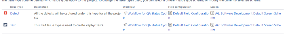

image.pngimage.pngHi,
I am not able to map the Test Field configuration with Test issue type. Kindly let me know if that can be done in this case.

According to your first screen shot, you already have

So, the First Screenshot is the Field Configuration scheme screen.I have assigned Test to Test Field Configuration.
When I check the Issue Type Screen (2nd screenshot) ,the Field Configuration is set to Default Field Configuration for Test issue type.

My guess is that in the second screen shot, you are looking at a project using a different Field Configuration Scheme.

In your project, can you double check you have applied the new Field Config Scheme?

To check if a field configuration scheme is applied to a project, read the project configuration settings - the fields section will name all the schemes currently used.
