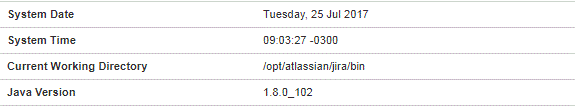

Hi,
I already changed on my configuration files the correct address to my jira home, but on JIRA it still appears the wrong address of my jira home.
Probably I miss some file, but I don't know wich file to search, the files that I made changes are:
/opt/atlassian/jira/atlassian-jira/WEB-INF/classes/jira-application.properties
/etc/inid.d/jira
opt/atlassian/jira/bin/config.sh
thank you!

Hi Artur,
The value you are looking at (Current Working Directory) is a pointer to where JIRA was started from.  Here's how I verified this:
  1. Stopped JIRA
  2. Created /jira-second-install
  3. Copied the contents from /opt/jira_install to /jira-second-install
  4. Started JIRA from /jira-second-install
Once I performed the above steps I went back to the Settings screen and the location had changed as expected.  If you want to change the location of the home folder:
  1. Stop JIRA
  2. Move your home folder contents to the location you would like it to exist in
  3. Change the location using the directions in Setting your JIRA Application Home Directory or use the JIRA Configuration Tool.
  4. Restart JIRA
Cheers,
Branden
