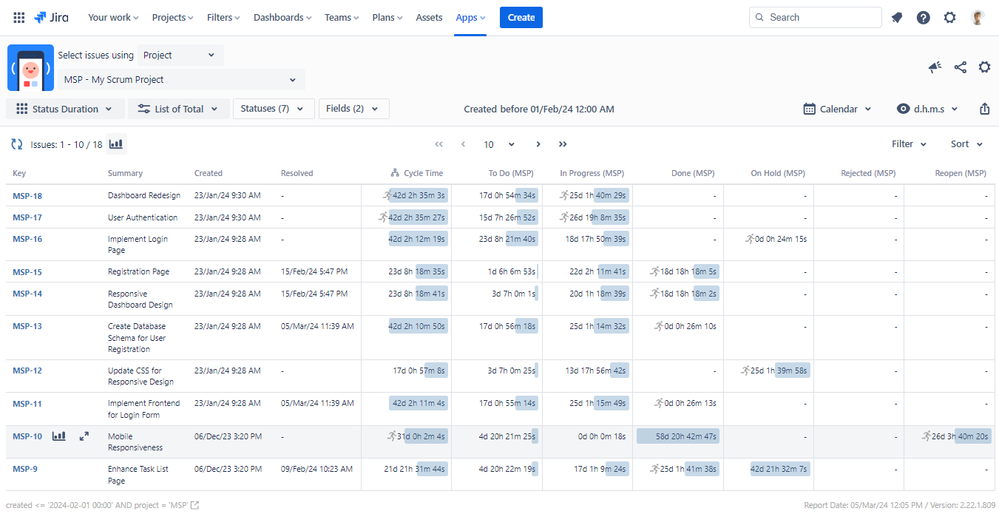

I've noticed that you are on free plan in Jira. So if you ever decided to consider 3rd party apps to track how much time each story spend on each status and create detailed reports you can use Timepiece - Time in Status for Jira, developed by my team at OBSS, free of charge.
Timepiece automatically calculates the total time issues spend across their lifecycle or within specific statuses, such as from creation to resolution. Key features include:
  • Status Duration Report: Shows time spent in each status and allows combining statuses to calculate metrics like Issue Age, Cycle Time, Lead Time, and Resolution Time.
  • Export Options: Generate reports in formats like CSV or XLS.
  • Dashboard Gadget: Add reports directly to Jira dashboards for easy access
Let me know if you’d like help setting up this report or need more information! If you wish, you can also schedule a live demo. We will provide a comprehensive overview of the application and address any inquiries you may have.
