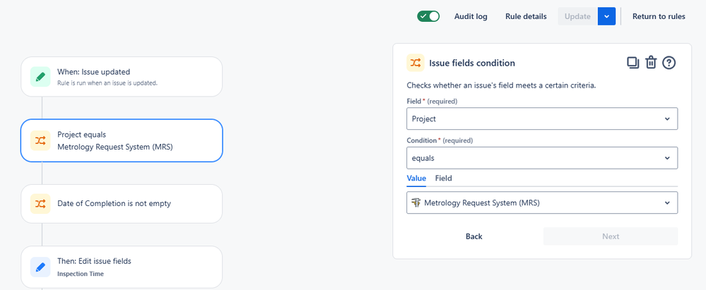

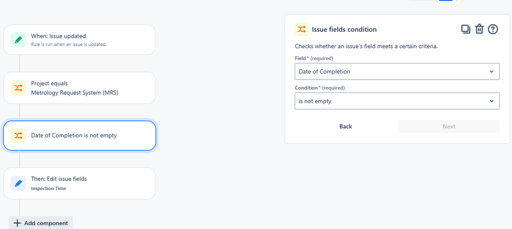

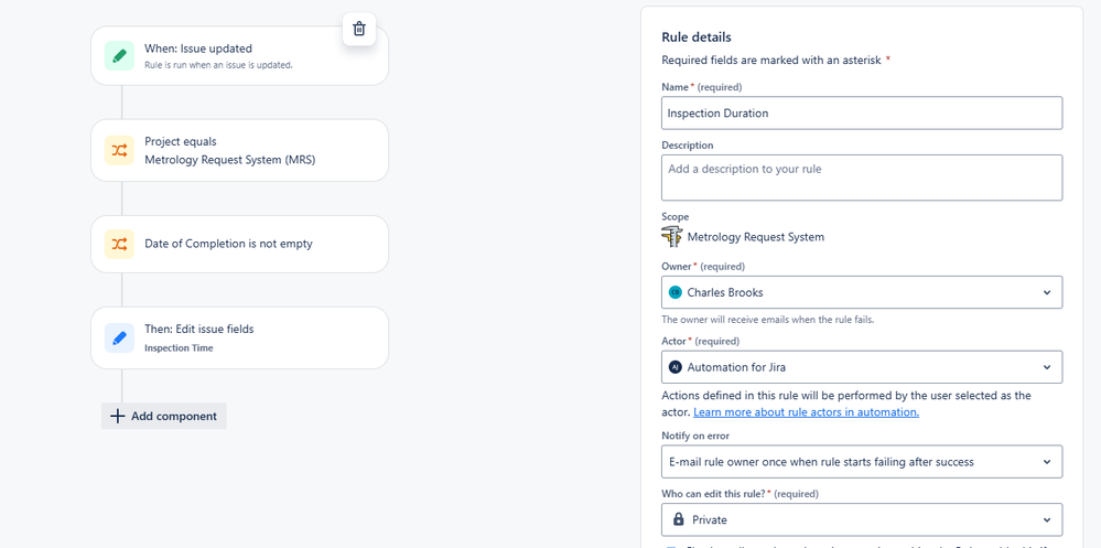

I have tried using the system field Due Date, inside my formula but I still can't get it to work.  I must be doing somethingScreenshot 2025-03-25 150111.png incorrectly here.
Bill Sheboy
March 25, 2025
Charles, what do you observe happening that is not working as expected?

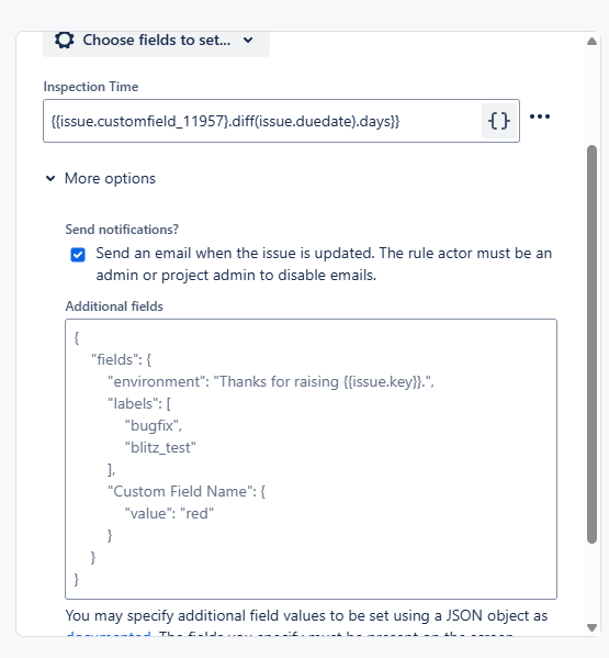

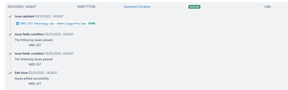

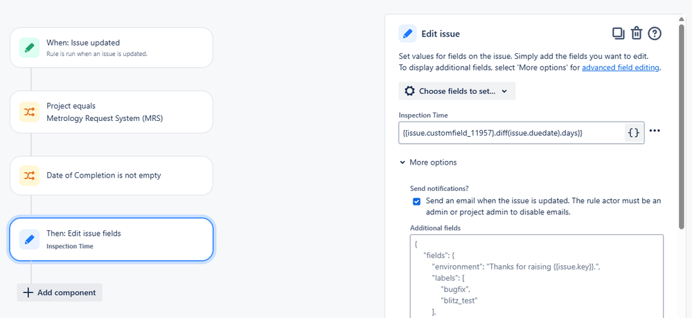

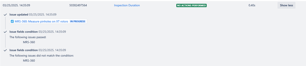

And, would you please post:
  • an image of the Edit Issue Fields action and
  • an image of the audit log details showing the rule execution, expanding all the details at the right side
Thanks!
Like Trudy P Claspill likes this
Charles Brooks
March 26, 2025
Screenshot 2025-03-26 070946.pngScreenshot 2025-03-26 071034.pngScreenshot 2025-03-26 071101.pngScreenshot 2025-03-26 071511.pngScreenshot 2025-03-26 071546.pngScreenshot 2025-03-25 150111.pngScreenshot 2025-03-26 070920.png

Hello @Charles Brooks
I see a typo in the smart value in your Edit Issue action.
You are using
{{issue.customfield_11957}.diff(issue.duedate).days}}
Notice the "}" character immediately to the right of the "7". You need to remove that character.
Like Bill Sheboy likes this
