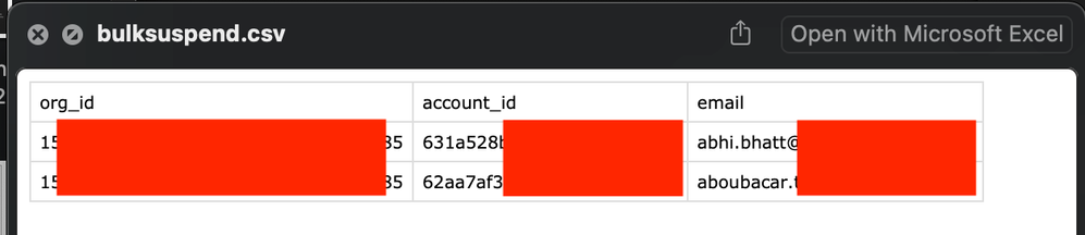

Bulk Deactivate is below
import pandas as pd
import requests
import json
import csv
url = "https://api.atlassian.com/users/{account_id}/manage/lifecycle/disable"
headers = {
"Content-Type": "application/json",
"Authorization": "Bearer YourAPI Key"
# Read the CSV file using pandas
df = pd.read_csv("bulksuspend.csv")
# Create a loop that iterates over the rows of the DataFrame with a step size of 50
for i in range(0, len(df), 50):
batch_df = df.iloc[i:i+50]
# Extract the required information from each row
for index, row in batch_df.iterrows():
org_id = row['org_id']
account_id = row['account_id']
email = row['email']
# Use the extracted information to form the request URL and headers
request_url = url.format(account_id=account_id)
payload = json.dumps({
"message": "On 6-month suspension"
# Send a DELETE request to the endpoint with the necessary headers and URL parameters
response = requests.request(
"POST",
request_url,
data=payload,
headers=headers
# Prompt the user if they want to proceed with the next batch of deactivation
if index % 50 == 0 and index != 0:
user_input = input("Do you want to proceed with the next batch of deactivation? (Y/N)").lower()
if user_input == 'n':
break
# If the user has not yet confirmed to continue with the next batch, prompt again
if 'user_input' in locals() and user_input == 'n':
break

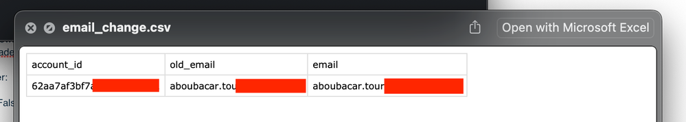

for the ones who like to use python since available almost everywhere in general,
Bulk Change/Update Emails
Preparation
Make sure you have admin account in Atlassian & once logged in create api key for the org,
https://admin.atlassian.com/o/xyz ---> settings ---> api keys, save it handy & secure place,
Make sure old_email & email domains are verified under same org, otherwise wont work.
Prepare your csv file & also analyze your directory. Because if email already exist, but suspended or not in use that you may want to rename to somethingelse before run it.
 Save the csv & python script at same location/path
required -> account_id, old_email(current), email(new)
Code is Below
#!/usr/bin/env python3
import requests
import csv
FILE = "email_change.csv"
API_KEY = "xyzabc"
with open(FILE, newline='') as f:
reader = csv.reader(f)
header = True
for row in reader:
if header:
header = False
continue
account_id = row[0]
old_email = row[1]
email = row[2]
print(account_id, " old_email: ", old_email, " -> new_email: ", email)
email = email.strip()
print(email)
url = f"https://api.atlassian.com/users/{account_id}/manage/email"
headers = {
"Authorization": f"Bearer {API_KEY}",
data = {
"email": email
response = requests.put(url, headers=headers, json=data)
response.raise_for_status()
print(response.text)
Also adding extra stuff below  that you may need in terms of bulk operations or find it handy
Bulk Suspend Accounts
 Preparation
https://admin.atlassian.com/o/xyz&nbsp; ---> settings ---> api keys, save it handy & secure place,
Prepare your csv file & make sure double check account_ids, do not disable wrong accounts :)
 Save csv & python script at same location/path
 *Suspended accounts do not cost license, they can be recovered anytime
required - > org_id & account_id optional -> email (just informational)
Code is below
