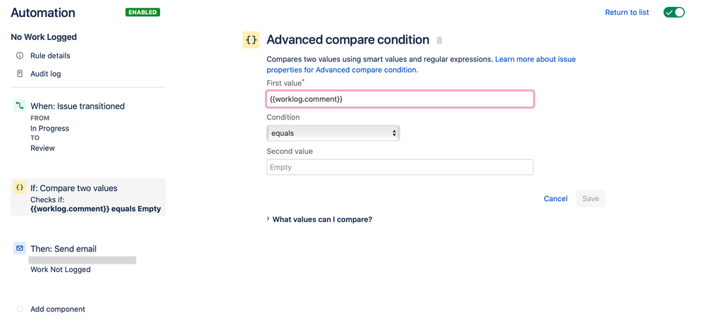

Okay, I've essentially found a way. I wasn't able to block the issue transition, but I was able to add a notification via email or MS Teams/Slack if an issue has no comment or has no logged work.
Answer:
  1. In Next Gen, use Jira Automation to create a new rule
  2. Trigger: Issue Transitioned (I used from In Progress to In Review)
  3. Condition: Advanced Compare Condition
    • First Value: {{worklog.comment}}
    • Condition equals
    • Second value empty
  4. Action: Send email
You can also do this with comments using same Condition and first value {{comment}}
I found this page to be helpful:
https://support.atlassian.com/jira-software-cloud/docs/smart-values-general/

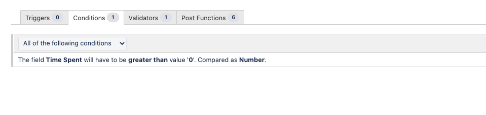

In a Classic project you can modify the workflow transition to add a Condition to disallow the transition unless Time Spent > 0. That addresses your requirement to have work logged.

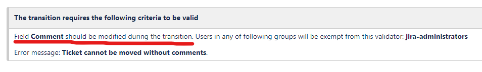

You can also add a Validator to a workflow to prevent completion of the transition unless the user enters a comment. You would have to add a screen includes the Comment field to the transition so that they could enter a comment during the transition. And that would not be able to check if a Comment of any kind had previously been entered on the issue. It would simply require the user to enter a comment as part of the transition.

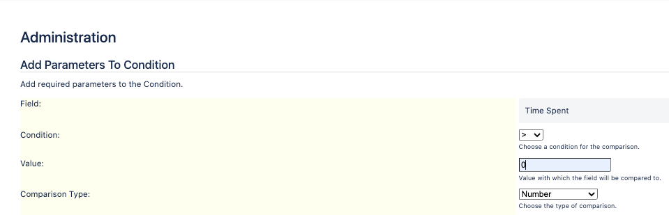

Trudy P Claspill
May 4, 2021
@Stefan Anghel
I have no problem selecting Time Spent as a field in the Value Field Condition

Stefan Anghel
May 5, 2021
@Trudy P Claspill thank you, I already resolved my issue thanks to an answer on another question.
You need to search for the field, the dropdown selection presents only a subset of possibile fields.

Hira Ahmed Shaikh
August 29, 2023
I have applied Validators as the image below. but users are not able to move the jira tickets now. even when comments are there. have I missed something.
Trudy P Claspill
August 30, 2023
Like • Hira Ahmed Shaikh likes this
Hira Ahmed Shaikh
August 30, 2023
Yes and it works. Thanks all for the support.
Hira Ahmed Shaikh
August 30, 2023
Yes and it is working well for me. Just as i wanted. Thanks to the Atlassian community for the support.
