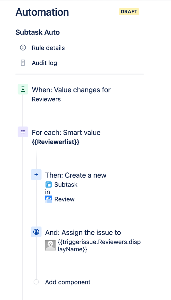

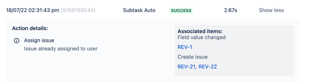

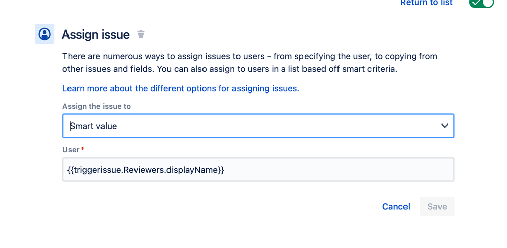

My team often has documents that need to be reviewed independently by multiple people. I would like to put these documents into jira tasks, then have a "People" field called Reviewers in the task that the reporter can add all reviewers to. I then needed the automation to iterate over the list entered into this field and generate sub-tasks for each person as well as assign the sub-task to them. I have gotten it to successfully generate the proper number of sub-tasks, but it does not assign them to the users listed. However, when I check the audit log it will say that it has run successfully and that the "Issue already assigned to user." I have included my configuration below.

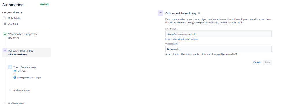

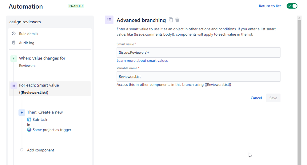

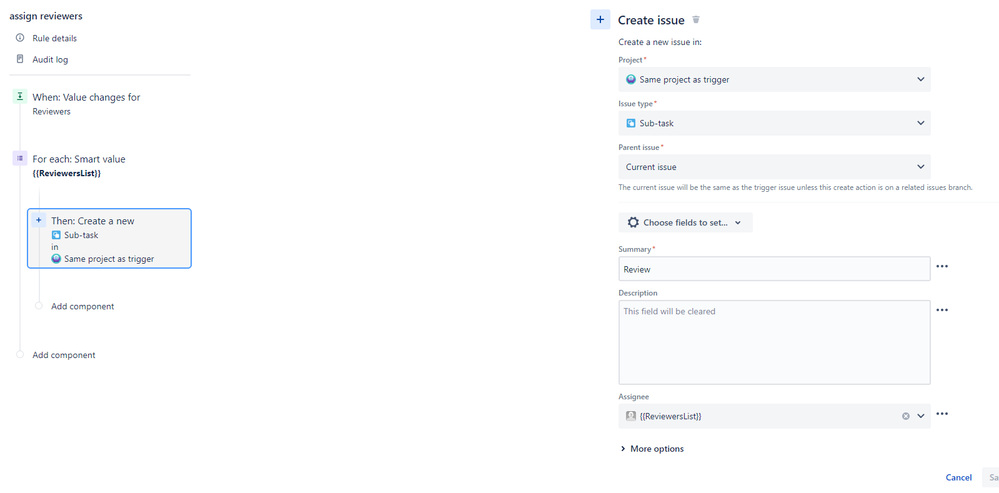

to set the assignee the accountId of the user is needed. Furthermore the forEachSmartValue acts like an iteration. So using the current value of the iteration to set the assignee will lead to success instead of using the triggerIssue.

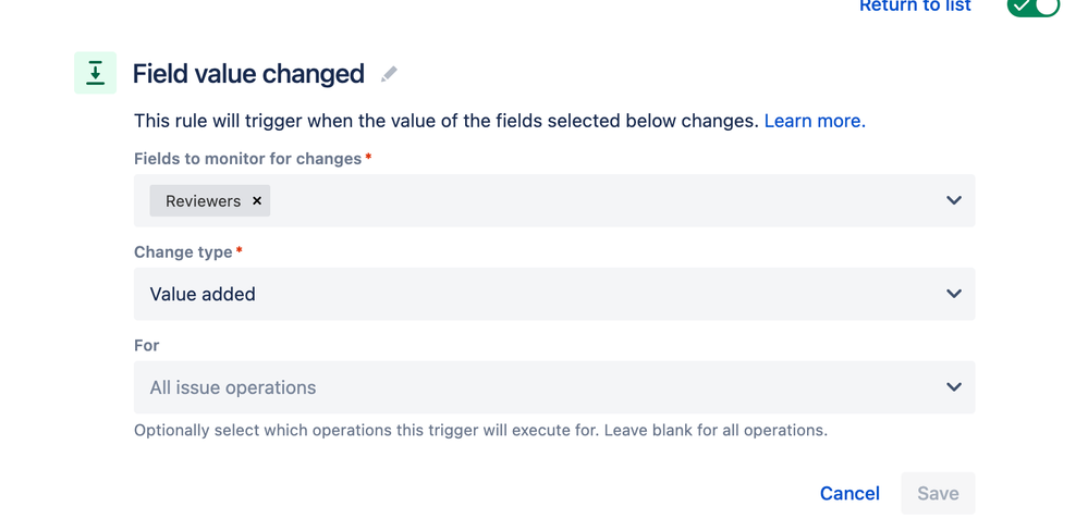

See the screenshots below of an automation rule I tested:
Hope this was helpful.
Best
Stefan
@Stefan Salzl Yes, this worked well and was very helpful! Putting the ((ReviewersList)) in the assignee field was the game-changer. Thank you!

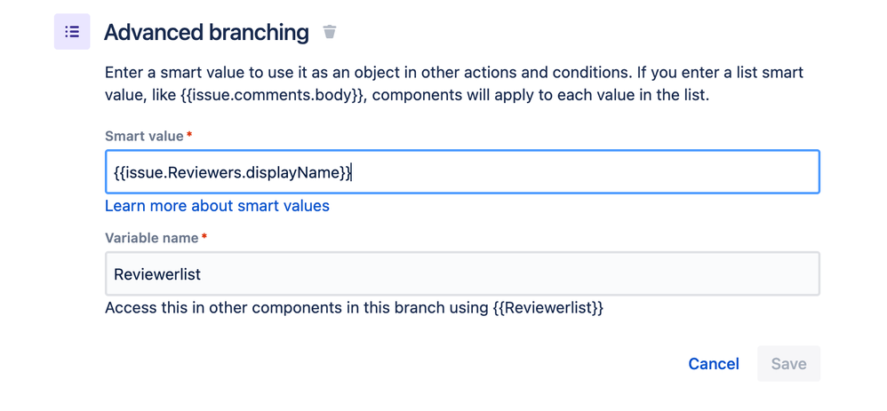

I have a question regarding this automation, is there any way we can add the name of each individual approver in summary associated with their subtask.
Regards,
Mayuresh Kamble
Hi @Mayuresh Kamble - welcome to the community,
if I got your requirement correctly: yes, this is possible.
There needs to be a change in the forEach branch as it should iterate over the 'Reviewers' field and then use the different properties (displayName for the name in the summary and 'accountId' for setting the assignee) within the branch (see screenshots below):
