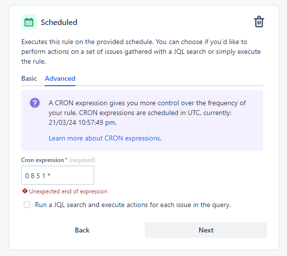

I am trying to build out a list of tickets to be created on a date towards the beginning of the year every year.
I've tried using the scheduling options with a CRON expression, but I keep getting an error message. Online research tells me the CRON expression is correct but no dice.
Does anyone have an option I can try to get the automation to run on the 5th of January every year?

Hi Kate, this is my new favorite site for CRON work.  Give this a shot
0 0 9 5 JAN ? 2025/1
It should trigger it on Jan 5 at 9:00AM every year starting in 2025

What is the "8" for in your expression?
Based on the page above, this expression should work:
0 0 1 5 JAN ? *
Run the rule at 1:00:00 am on the 5th of January, regardless of the day of the week that is on, every year.

Thanks for the expression - proven to work! My one had the 8 in it as I was hoping to have it run at 8am on the 5th. Looks from your response that I needed another 0 at the beginning to make a correct CRON expression.
