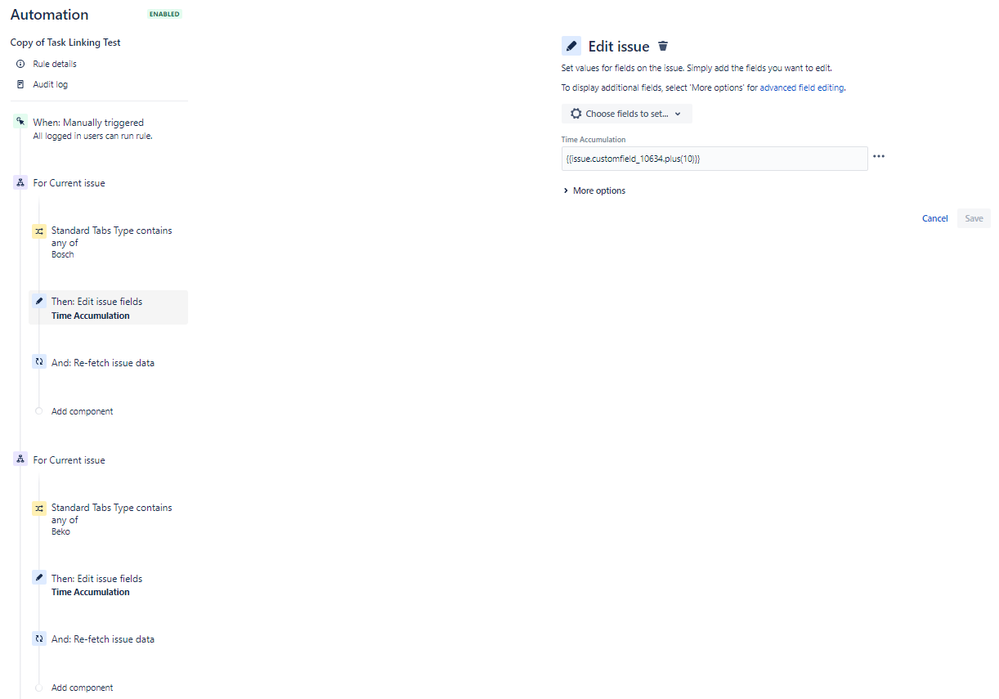

@Bill Sheboy  Thanks for the clarification, I just did a test with a simple number field and the same behavior occurred even with the re-fetch. It ignores the previous "if" statement adding a value and only does the last one that is run. I did put a re-fetch at the end of both if/else conditions.

@Bill Sheboy I have found that if I pull the "re-Fetch" out of the condition/branch it works.
It looks like this:
  • trigger: manual
  • if/else
    • issue field condition: Standard Tabs Type contains Bosch
    • action: edit the field
  • action: re-fetch
  • if/else
    • issue field condition: Standard Tabs Type contains Beko
  • action: re-fetch
This has been the only way I have gotten it to work.
Thank you for your help though, wouldn't have got on the right path with out it.
