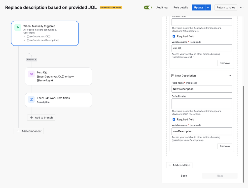

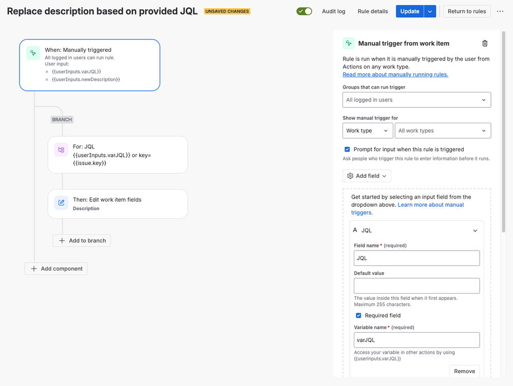

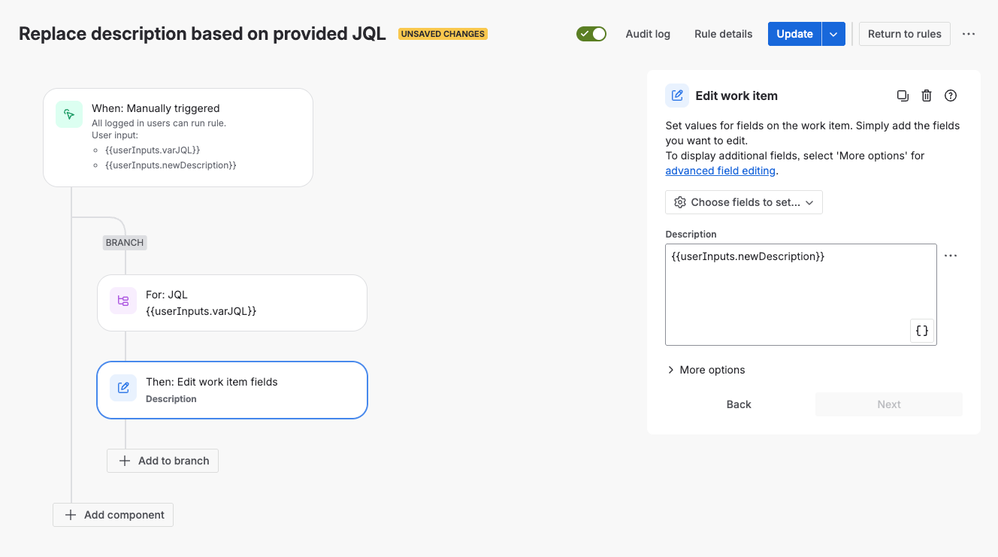

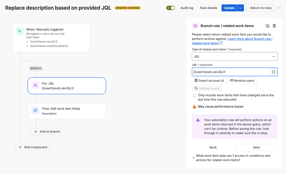

The basic rule would be something like this:
Screenshot 2026-01-27 at 3.38.14 PM.pngScreenshot 2026-01-27 at 3.38.26 PM.pngScreenshot 2026-01-27 at 3.38.43 PM.pngScreenshot 2026-01-27 at 3.38.53 PM.png

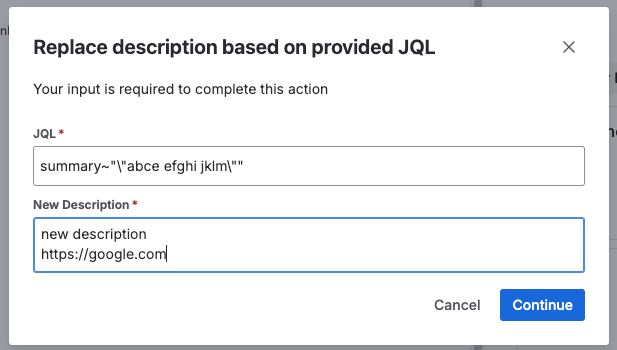

This rule prompts for the JQL you want to use to select the issues to update, and the new text you want for Description.

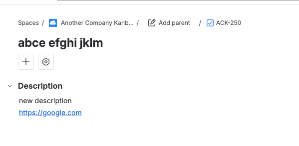

It will do a full exact match on the Summary field when the JQL is entered as shown above. And here is the result.

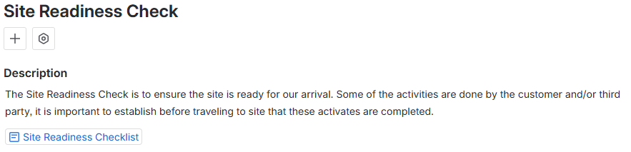

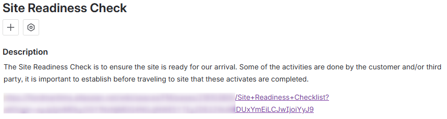

I also included a Confluence link. When i normally paste this in the description Jira automatically changes the link into a Inline representation. With the automation it will show the URL only, which works but would be nice if displayed as Inline link. Is there a way to fix this?
Trudy P Claspill
January 28, 2026
The URL that I used in my example came through as a clickable link. Is that not the case for the Confluence URL you paste?
I will test with a Confluence URL to see what happens, and get back to you.
Rob Peters
January 29, 2026
It is a clickable link, that works fine and bring you to the correct Confluence location. See below screenshot.

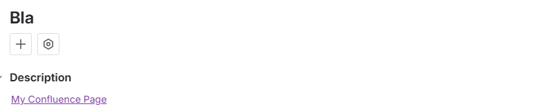

What I prefer is that this link is shown as a Inline link, but this is difficult to achieve according ChatGPT :-)2026-01-29_11h36_52.png
But i found suggestion to use "markdown"
[My Confluence Page]("URL")
