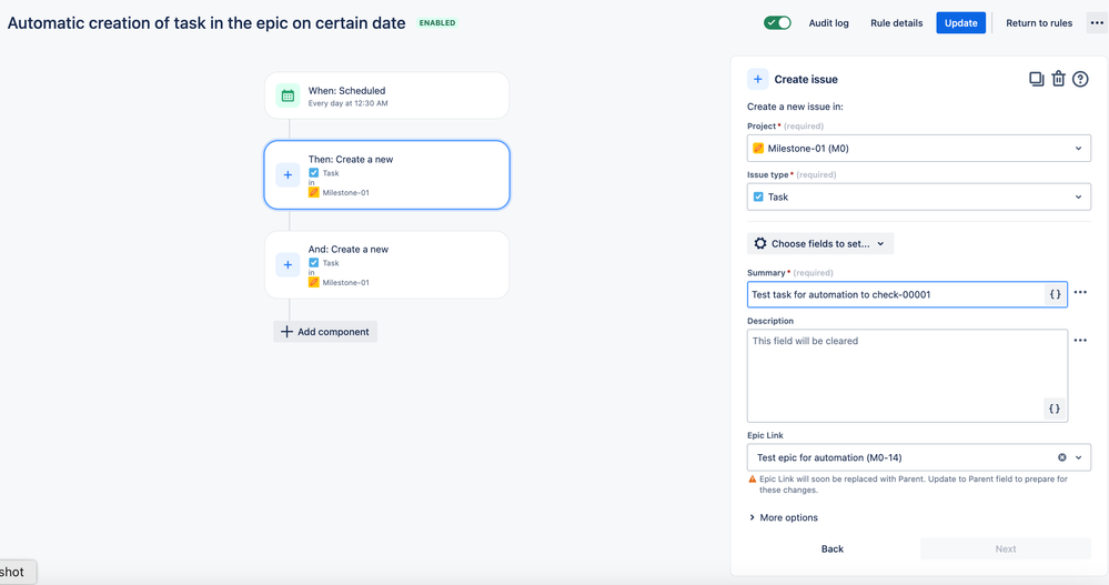

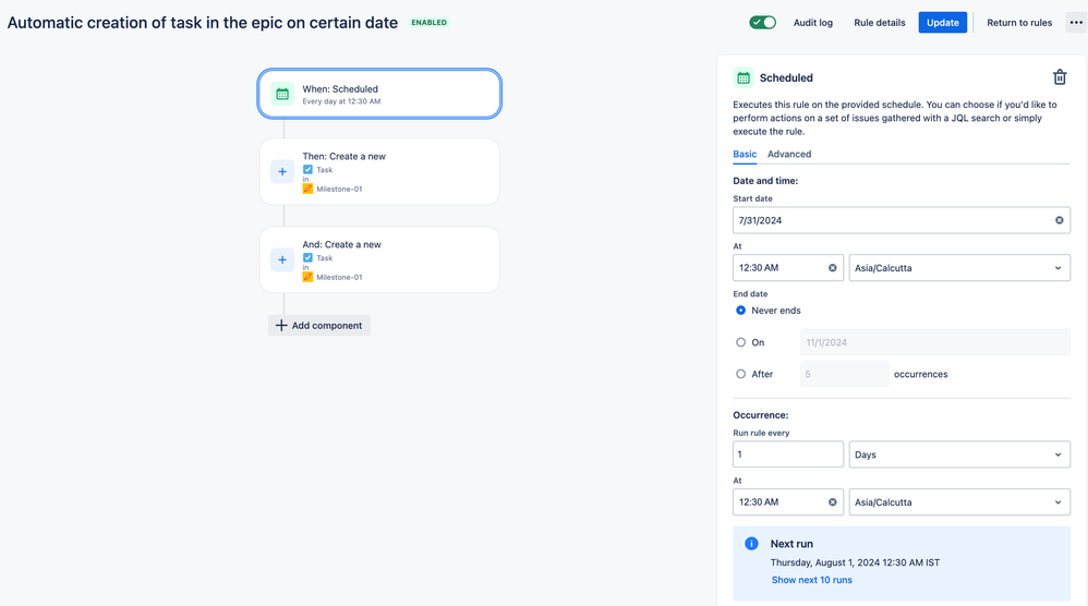

Hi @Steve Gardner  , I am sharing the automation rule i have created in my test environment for creating two task everyday with Summary field value only and it is getting created under the existing epic.
The setting for 2nd task will be same only except the summary details and like wise you can create multiple task, story under same epic using the same automation rule based on the requirement.
Please have a look and see if you are able to replicate the same in your case and let me know if you need any further assistance with this?

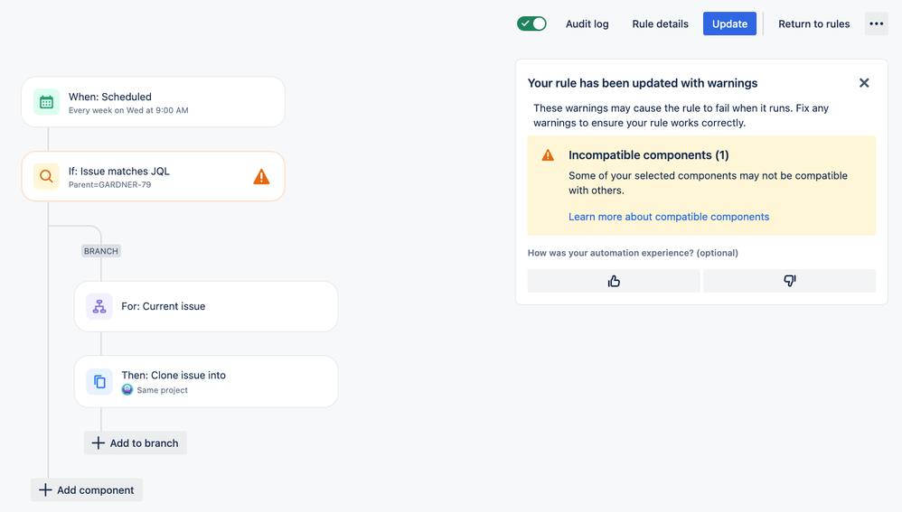

I keep getting incompatible components error messages...
1) When schedule -
2) if Issue matches JQL  Parent = EPICNUMBER
3) Branch
3A) For Current issue
3B) Then Clone issue into same project

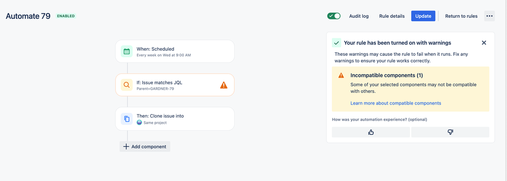

And then when i set the logic up to not use a branch the way thi woudl intuative thinkn about it...it gives me the same type of error - Incompatible componenets...
1) When Scheduled
2) if issue matchs JQL (Parent = ParentID) - exact code is Parent=GARDNER-79
3) then clone issue into current project...
why isnt it this simple?
