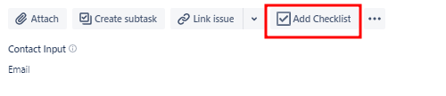

When I look at issue types that are already created I see an option to a Add Checklist manually once the Issue Type is created.

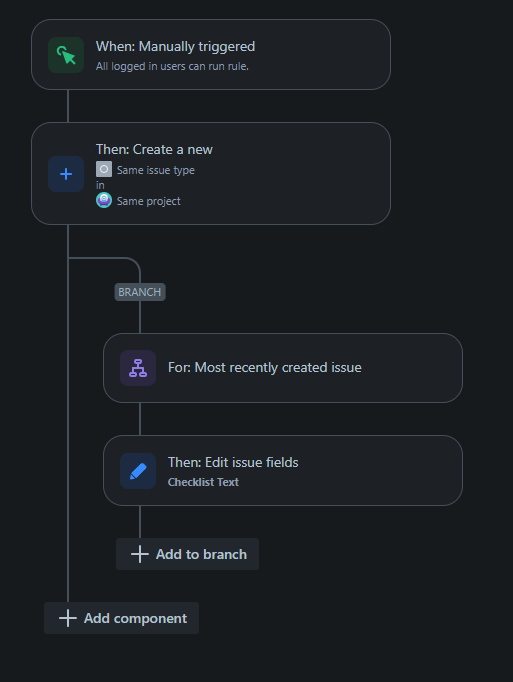

I tried using the checklist in a manual trigger but i didn't work, it works fine in automation when i don't use the manual trigger.
Henry Kwon
February 15, 2024
I found a solution for a manual trigger.
Like Ismail Sanni likes this
Ismail Sanni
February 22, 2024
@Henry Kwon Thanks, this works

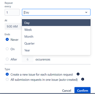

My team has developed Forms & Checklists for Jira and BPM. And we have one more solution that helps to automate checklist creation.
Try out the Recurring Checklists and Report add-on.
It allows adding checklists:
  • manually by adding checklists to the existing issue
  • automatically bu scheduling
Learn more in our documentation!
