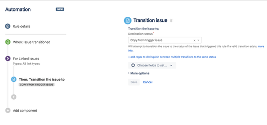

- Create another rule that will update the status when the other issue is transitioned:

I've configured it globally and issue is being created in the target project and the issues are also being linked.
But when I perform the transition the status is not updated in JSD project.
In both the project same workflow is configured, when i check the logs i'm getting an error stating no transition to the specified status.Screenshot from 2018-10-05 13-39-48.png
