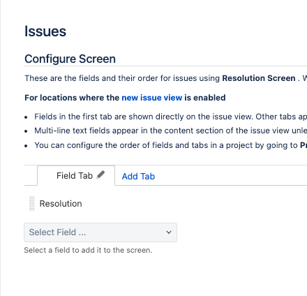

In this example I use the Resolution field. First I create the Screen with that field.

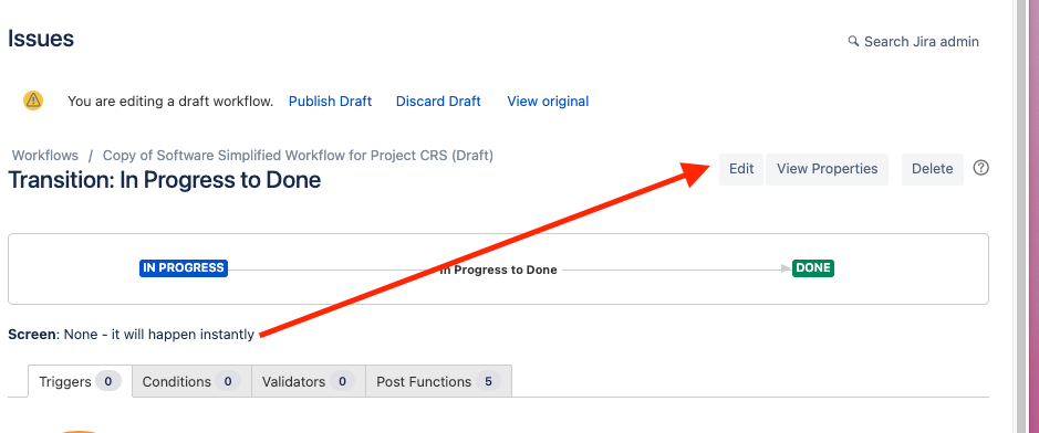

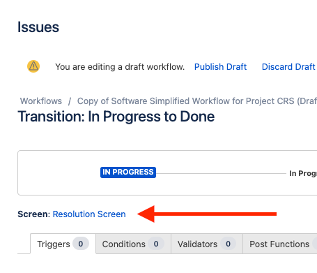

Then I modify the workflow to add the screen to the transition.
Screen Shot 2023-06-01 at 10.59.50 AM.pngScreen Shot 2023-06-01 at 11.00.16 AM.png
Then publish the workflow.
After that when the transition is executed the specified screen will appear and the user can fill in the value.
