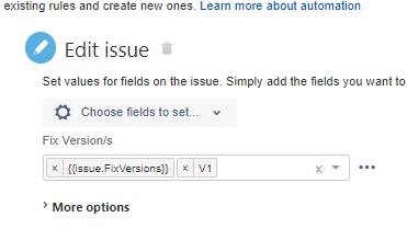

Not sure what the trigger of the automation is but you can append FixVersion by using the edit issue action and FixVersion field with the following value.
In this example if add V1 to the current list of versions.

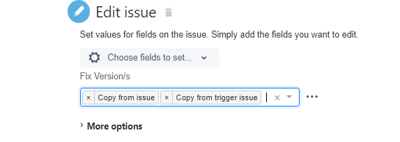

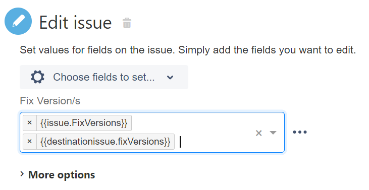

If so, the rule is supposed to update the linked issue fix version field with the value of the destination issue; it does that but it also overwrites the exisiting fix version values, so I've come across the item I have posted in my question description.
I have followed your suggestion and as said it works but overwriting the existing values:
I understand there is a work aroud by using the Advanced Edit but I don't get right the JSON syntax or genuily there is a bug.
Thanks, Vincenzo.

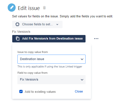

Have you try this configuration ?
Select FixVersion then ... > Copy From and the config above.
Check add to existing values
Regards

vincenzo.spatafora
September 19, 2024
Thank you @Florian Bonniec
yeah, that's the way to do it; it works.
So true: sometimes you are in the woods and you don't see the tree.
Kind Regards, Vincenzo.

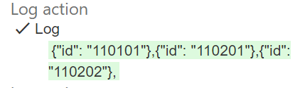

Can you log the value of smart values
{{#issue.fixVersions}}{"id": "{{id}}"},{{/}}
for me?
vincenzo.spatafora
September 18, 2024
Thanks @Dick for your time.
So, the syntax from the post above is correct (in step 4).
Here the log:
