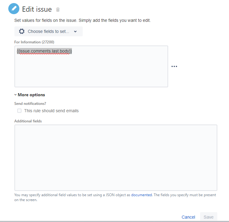

Dear ALL,
I would like to implement an automation rule in order to append the last comment of an issue to the multi line text field of this issue without overwriting the existing lines.
My syntax is:
{ "update": { "customfield_27200": [{"set":"{{issue.comments.last.body}}"}] } }
but it doesn't work.
I have also tried with "set" (instead of "add") and it doesn't work either.
Can you please let me know?
I use Jira DC version 9.12.12.
Thanks in advance, Vincenzo.

vincenzo.spatafora
October 18, 2024
Thanks @Marc -Devoteam-.
Not sure I fully understand.
Do you mean from "Edit issue" to select my multi line text field and then to add {{issue.comments.last.body}} as for below:
Cheers, Vincenzo.
Marc -Devoteam-
October 18, 2024
Hi @vincenzo.spatafora
Yes the Edit action and select the multiline field
But add :
{{issue.For Information}} or {{issue.customfield_27200}}
The first smart value is to retina the original content.
Check which smart value you need to retain the original field value the name or custom field ID
vincenzo.spatafora
October 18, 2024
Hi @Marc -Devoteam-,
tried out both cases and it didn't work for me.
I have logged the value of either
{{issue.For Information}} and  {{issue.customfield_27200}}
and the log is empty actually.
Thanks, Vincenzo.
Marc -Devoteam-
October 21, 2024
HI @vincenzo.spatafora
Then crate a variable first based on the custom field and then the edit.
Then use the variable instead of the
vincenzo.spatafora
October 21, 2024
thank You very much, now it works.
